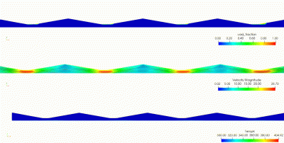

I checked and ran your case with CS 7.0.4. The time step discretization in your setup was set to steady, but in this situation the regime is transient. The simulation now runs with a time step of 1e-4 s (Co max ~ 2.5) after the change. It is accurate to say that the maximum fluid velocity is around 27 m/s, which results in a negative (total) pressure in the venturi region.
In the lower pressure areas, void fraction is produced when the Vof + cavitation model is active.

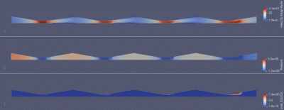

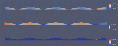

See for example the following different velocity profile with different CO Thank you,
Lorenzo
