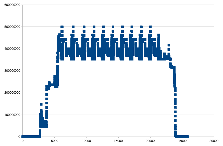

- Posts: 4299
Re: Free memory constantly decreasing
There is no "instrumented" memory which seems to leek, and the instrumented memory usage does not seem to leak (importing your file under a spreadsheet and plotting the memory use over allocations_ I get this (which is good, as you seem memory being allocated and freed in equal amounts at each time step) :
So it seems this is in a non-instrumented part of the code (or possibly but with less probability only on some nodes, if this is for example due to a boundary array). Is the beta function for turbulence modeling a function in the code (in case which one ?) or your own modification (in which case can you provide it so I can check it ?).
