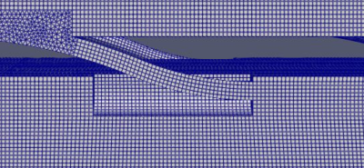

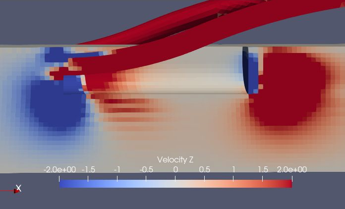

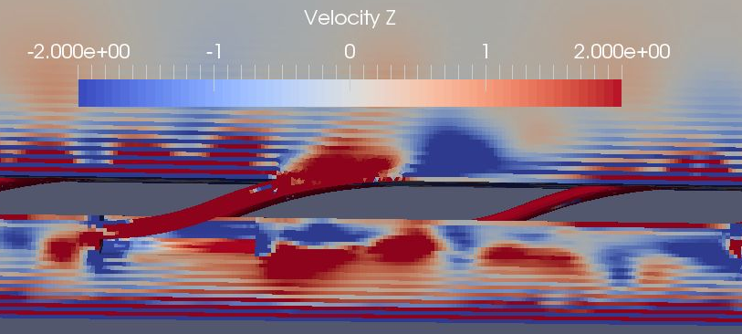

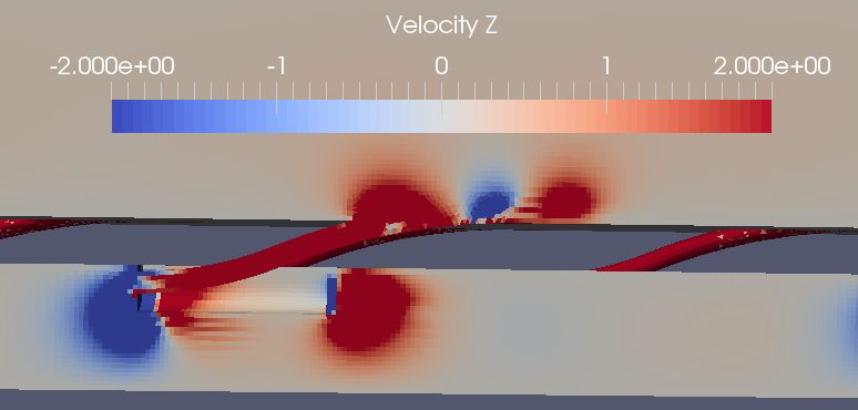

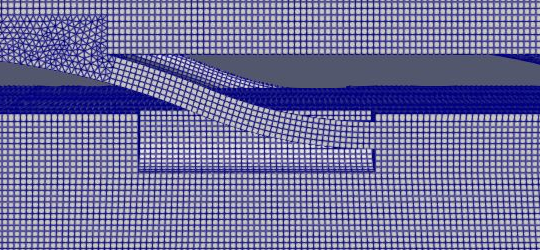

in a very early stage of my CFD I could observe solution artefacts in the z-component of the velocity (the stripes in the solution), Bulk velocity (x-direction) is approx. 30m/s.
With ongoing solution process the solution worses and a pronounced pattern in the velocity is visible.
I've tried the different solution schemes (upwind, centered, solu), different values for pressure relaxation, gradient calculation (Gauss-Seidel, Least Square), pressure gradient extrapolation, blending ... but nothing helps.
Do you have a hint for me how I can avoid this? The grid may not be the best, but is mostly a regular hex cell grid and all quality criterions are fine:

Which version of the code is this ? Could you post a few solver logs ? This might be a CFL/Rhie & Chow filter issue. In any case, logs should help to try to pinpoint the issue.

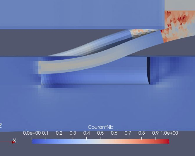

The CFL-Numbers seem to be in a valid range, There are a bit large in the tetrahedral region but shouldn't cause the checkerboard pattern.
I've attached the XML-file and the logs. CS-Version 6.0.4

Did you try "improved pressure interpolation in stratified flow" in the numerical parameters ? This is now the default in v7.0, and may have some influence n cases with buoyancy (it has also been slightly improved in development versions, though I would not expect a significant difference with the v7.0 implementation).
Another option than might have some influence is the "irevmc" (reconstruction of velocity with updated pressure).

another test that can be carried out is using a local time step (time- and space varying, 'pseudo-steady') ; starting with a reference time step 'not too small' (for instance 10^(-4)s) - this may contribute to stabilize your results.

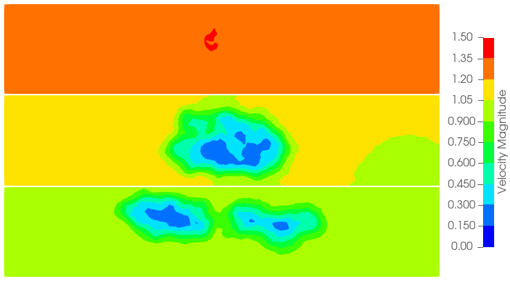

I faced similar but not the same problem. Fluid domain is a rapid channel turn with rectangular head loss / heat source region after it (heat exchnger). Velocity level in head loss region is about 1..2 m/s. Although streamlines look reasonable (near straight due to distributed resistance) in some zones velocity drops to very small values and then return back to normal. In a cross-section of resistance region it looks like blue spots on velocity magnitude contour. Switching to first-order discretisation (Upwind) didn't help. In the same zones there is all good in CFX results (although CFX created apparent artifact in another place that is characteristic for it). Pressure field is OK. Density profile is OK.
Saturne version: 7.0.2
Mesh type: tetra without inflation layers
Fluid: Air with variable density
Turbulence: default k-epsilon
Temperature scalar: Temperature Celsius (approx 30...150 *C range in heat exchanger)
Gradient: Least squares + all vertex adjacent
Improved pressure interpolation: On
Time stepping: Local timestep
Reference timestep: 0.0001 s
Target CFL number: 2.0
Local timestep range: 0.00029...0.1 s
Local CFL range: 0.010...8.5
Case XML file, listing and artifact illustration are attached.

The problem disappeared after reducing target CFL number from 2.0 to 0.5...1.0 (real local CFL maximum < 2). So it was numerical scheme instability. But, in some cases, there may be instability indeed with lower target CFL numbers, so it's not a universal solution.
