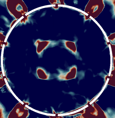

I am trying to solve the large eddy simulation for a vertical cylinder, which has two-inlet boundary conditions. The issue with the simulation is there are some artefacts (possibly due to the mesh) throughout the cylinder in turbulent kinetic energy and velocity calculation. I have tried the simulation with different SGS models for instance wale model, smagorinsky Lilly model, or no model (basically implicit LES). I have used the Least-squares method overextended cell neighbourhood scheme under pressure relaxation factor of 0.5. Moreover, I am using the constant time step option with a reference time step of 5*10-4. We are using liquid metal as a working fluid.

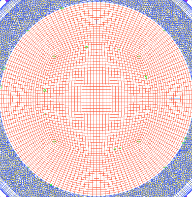

For the meshing, I am using the ICEM software with a general o-grid mesh (structured mesh) methodology.
I have attached the setup log file. please have a look.
Artefacts

The artefacts closest to the center of the mesh really seem to correlate with the mesh (you can visualize mesh quality criteria to compare).
For the others, it seems less clear.

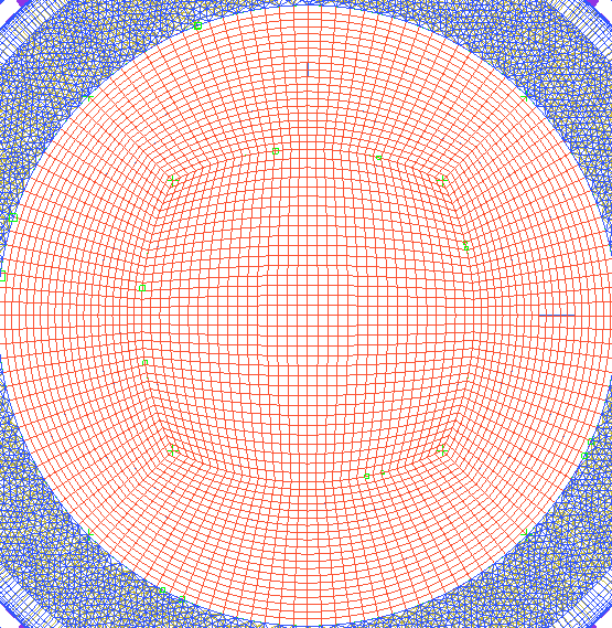

As per your suggestion I have checked the mesh quality criteria and some non_ortho mesh has been detected (please find the attached image). Additionally I have tried the simulation with a blending factor of 0.95 for velocity (second order linear upwind) and with pressure relaxation value of 0.2. I have tried the simulation with both numerical schemes the green-gauss with iterative scheme of non-orthogonality as well as green-gauss with least square face values. In both of the cases with the above mentioned conditions (pressure relaxation = 0.2; blending factor = 0.95) the simulations have diverged. The simulation have diverged in a very early stage (i.e. after 2 or 3 iterations).
Thank you for your reply.
