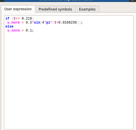

Hello everyone.I need a small favour to ask.If someone could guide me and provide me with a very close subroutine that serves the purpose I am trying to do.I have done the part in the GUI but want to use a subroutine in the hope that it will reduce my simulation time from 1.5-2 days to less time.

The expressions used in the GUI are already converted to compiled code (see cs_meg_* files in the src directory of a case that has run), so do not expect any gain from using a user-defined function here.
For performance, did you look at the performance.log file to see which steps are the most costly (usually linear-equation solvers and gradients) ?
