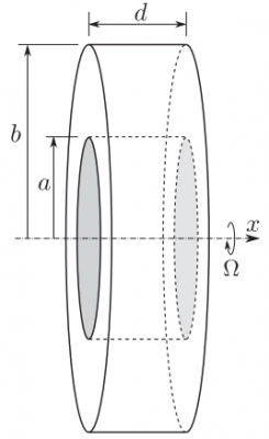

Dear developers,
Could you please help me with this question?
I use the latest master version with GUI. My model is a closed rotating cavity, shown in the figure below. I want to put the entire domain in a rotating reference frame. So for the "Turbomachinery model", should I use "Frozen rotor model" or "Full transient simulation"? For RNS and LES, should I choose the same or different "Turbomachinery model"?
I learned frozen rotor or full transient are for interface behaviour between rotating domain and stationary domain. But in my domain there is no interface, so I don't know which to choose.
And the strange thing is, for LES, when I use "full transient", the velocity result is not reasonable; but when I use "frozen rotor", the velocity result is ok. So I'm confusing.
Many thanks,
Ruonan
