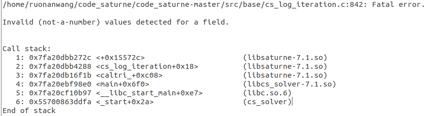

I'm trying to run an LES solution, restart from a converged RANS solution, to make the LES solution converge quickly. But one error occurred: "Invalid (not-a-number) values detected for a field".
I checked the log file, guess maybe it's because of an error when restarting LES from the previous RANS result. I have no problem when restarting an LES solution from a previous LES result, or restarting RANS from RANS.

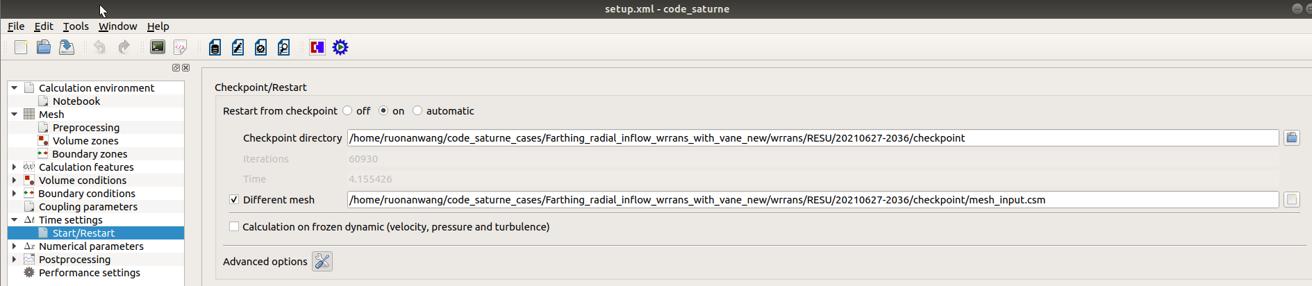

Another thing need to mention is that, the previous RANS mesh is coarse, and the current LES mesh is refined. But the CFD model is the same. So I ticked the "Different mesh" box, and choose the .csm file from the previous RANS checkpoint folder. Also, in "Advanced options", I didn't tick the "Read the auxiliary restart file" box.
Could you please suggest to me, if the setting is correct or not? And how to deal with this error? Thank you so much for your help!

I received another bug report and test case for a similar issue, probably the same one as here. I located the error (exponential in RANS to LES term, with negative R_00 value in some cells; in src/turb/cs_les_synthetic_eddy_method.c, line 1670 for current master branch), and an checking with colleagues which formula should be used there instead of the current one. So I should have a fix very soon.

I got the fixed version from Git but I still received the same error as Ruonan mentioned before, when I tried to restart LES from RANS.
src/base/cs_log_iteration.c:842: Fatal error.
Invalid (not-a-number) values detected for a field.
Did I make a mistake? Looking forward to your reply, thank you so much!
