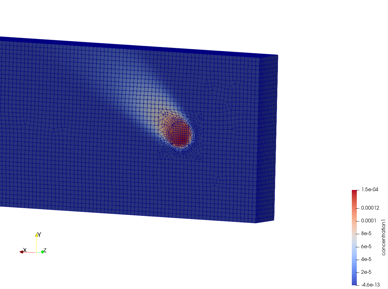

I am trying to perform simulation with the atmospheric module in order to test dispersion scenari of user scalar with an Eulerian approach (concentration of pollutant in this special case)
The pollutant is quite dillute (very low volume fraction) and we are working in steady flow. Besides, many dispersion scenari are likely to be tested, so we would like to divide each cases as follows:
- simulation of flow without pollutant (monospecies)
- simulation of the pollutant dispersion through the previously calculated frozen carrier flow. Such a pollutant comes from a surface source at the domain border (modeled as smooth wall in the previous stage).
I try to work only with the GUI. Regarding the dispersion of pollutants, I choose a Dirichlet boundary condition imposing a constant concentration value at the source.
The flow simulation gives satisfactory results. Nevertheless, it seems that the dispersion case does not match the boundary condition at the source. Indeed, the simulation tends to underestimate the value I impose with the boundary conditions by ca 90%. Such a value is not even reached in the overall domain. Besides, the concentration profile at the surface is not uniform.
Is there something I am missing? I work on Code_Saturne v6.0.6.
Please find attached the complete project. (You can launch flow and dispersion with the runall.sh script in DATA folder. Just add the path where code_saturne executable is located)
Thanks for your attention. I’m looking forward to your reply.
Matthieu

I already tried to use a flux boundary condition instead of Dirichlet. I am facing the same issue regarding the concentration profile at the surface, which remains inhomogeneous. Can it be related to the fact that I imposed wall boundary conditions for the flow in the first stage?

I just tried to simulate dispersion in a non-frozen flow :
- with unchanged boundary conditions for the flow (wall at the pollutant source): imposing a Dirichlet boundary condition for the user scalar gives similar results as frozen flow case, as well as flux boundary condition.
- Switch from wall to inlet boundary condition for the flow at the pollutant source: imposing a Dirichlet boundary condition for the user scalar still leads to concentration values much lower than the one imposed by ca 90%, but the concentration profile tends to be homogeneous! (We can not impose a flux BC at the source for the user scalar in this case of course.)

I just put a convective inlet BC at the source as you suggested, for dispersion in a non-frozen flow. The concentration profile is quite homogeneous. Though the max value (near pollutant source) remains under the prescribed concentration at the source by ca an order of magnitude. I attached a screenshot of results, focused on the pollutant concentration near surface source (diskus shape) at the ground. I prescribed value of 0.001.
