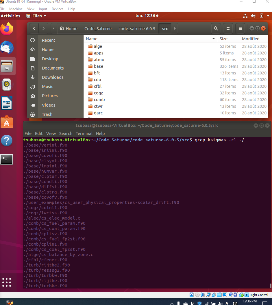

Now, I am looking for information about Schmidt number and how much default it is in code saturne.
Then I want to check the source code, but where can I check this in the following src directory? Sorry I am not familiar with this kind of computational things,

In most cases, it is recommended to search in all directories, but in this case, "base" (and possibly turb, for the turbulent Schmidt number) are the best places to look.
I also remember there was a recent comment on our side about the naming of the Schmidt number. I need to check, but if the way this is implemented does not seem to fit the standard definition, but includes another multiplier or divisor, do not hesitate to comment here.

I found "default" Schmidt and Prandtl number in code saturne.
Let me answer myself to be sure.
This can can be seen in src/cogz/coini.f90
So the default value is 0.7 for Schmidt (also Prandtl number), isn't it?
