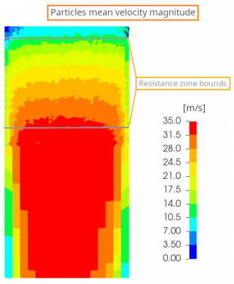

Hello. I guess I found the bug in Saturne 6.0.6. I'm not allowed to share the entire geometry, but, I think, it's not a matter of particular case. In this case, there is a gas duct with recirculation line intake and head loss volume zone that represent the tube bundle. Gas phase calculation was successful (tube bundle resistance is accounted for without problems), then I introduced particles on frozen gas velocity field. Although particles move by expected streamlines, when they enter volume zone with head losses, their velocity rises gradually by ~25m/s (gas velocity is around 7.5 m/s in this area). I attached picture with particles mean velocity field.
Case setup is very basic. Gas velocity in problematic area is ~7.5 m/s (aw well as particles velocity before resistance zone), gas pressure drop across resistance zone is ~250 Pa at height of 1.2 m (resistance coefficient is 16.8 m^-1). Gas density is 0.365 kg/m3, dynamic viscosity is 3.17e-05 Pa*s. There are 9 particle fractions (classes) with sizes from 2.5 to 100 mkm. I attach case setup [xml] files for gas-phase and particle runs (case for gas-phase run is marked with A suffix that means "pure aerodynamic"). Please note that, in particles case, some values for gas phase are not set.

Would anybody, please, fix this particle acceleration in resistance zone? Maybe pressure gradient force is accounted for incorrectly?
BTW, Saturne gave 11% of particles coming into recirculation line while Fluent gave 15% that is quite good agreement (this case's purpose is to ensure that Fluent doesn't give us too low particle fraction in recirculation line).

Hello, thanks for so fast reply. Sorry, but, I think, it cannot be due to a missing force on particles because, if you leave such particles with only drag and gravitational forces under case conditions (given densities and gas viscosity, constant gas velocity), they will not accelerate more than by 1.1...1.4 m/s (terminal velocities by 3 different models for largest particle class of 100 mkm). So I can only guess that you consider gas pressure gradient force on particles and there is a mistake like unit conversion in pressure gradient force. Although it may be something more deep. Hope you will fix it without problems.

What Martin means is that when using head losses in code_saturne, an external force is always added, but the Lagrangian module does not take it into account in a consistent manner, which explains the issue you have. This is more a refactorization issue in the code.
If you are trying to reach a steady state and have one-way coupling, a workaround would be to use head losses in an initial Eulerian computation, then run a "frozen field computation" , removing the head losses to avoid the extra term. For a coupled computation, a fix in the code is necessary.
