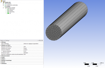

I would like to know how you usually proceed to import CGNS mesh from Ansys Mesher to Code_Saturne 6.1.
I describe my problems and interrogations :
Context :
MESH CGNS 3.2 ADF from Ansys Mesher
Code_Saturne 6.1 (Code_Saturne GUI only !) on Ubuntu 20.04 LTS
Main proplem :
When I import mesh to Code_Saturne and I run case, case running console writes :
Compiling user subroutines and linking
Preparing calculation data
Single processor code_saturne simulation.
Preprocessing calculation
Post-calculation operations
Error running the preprocessor.
Check the preprocessor.log file for details.
Error in preprocessing stage.

Posts: 4277
Re: Ansys CGNS to Code_Saturne 6.1
Some CGNS files generated by older CGNS libraries are not readable directly without recent CGNS versions (due in part to changes in the handling of Polyhedra, but since CGNS tries to achieve backwards and forwards compatibility, the cause is probably more subtle than I can explain).
In any case, when you installed CGNS with code_saturne, in the "bin" subfolder of the CGNS installation, you should find a "cgnsupdate" file. Try running:
<path_to_cgns_bin>/cgnsupdate <your_cgns_file>
and see if you can read it afterwards (in any case, this has worked for colleagues using ANSYS meshing also).

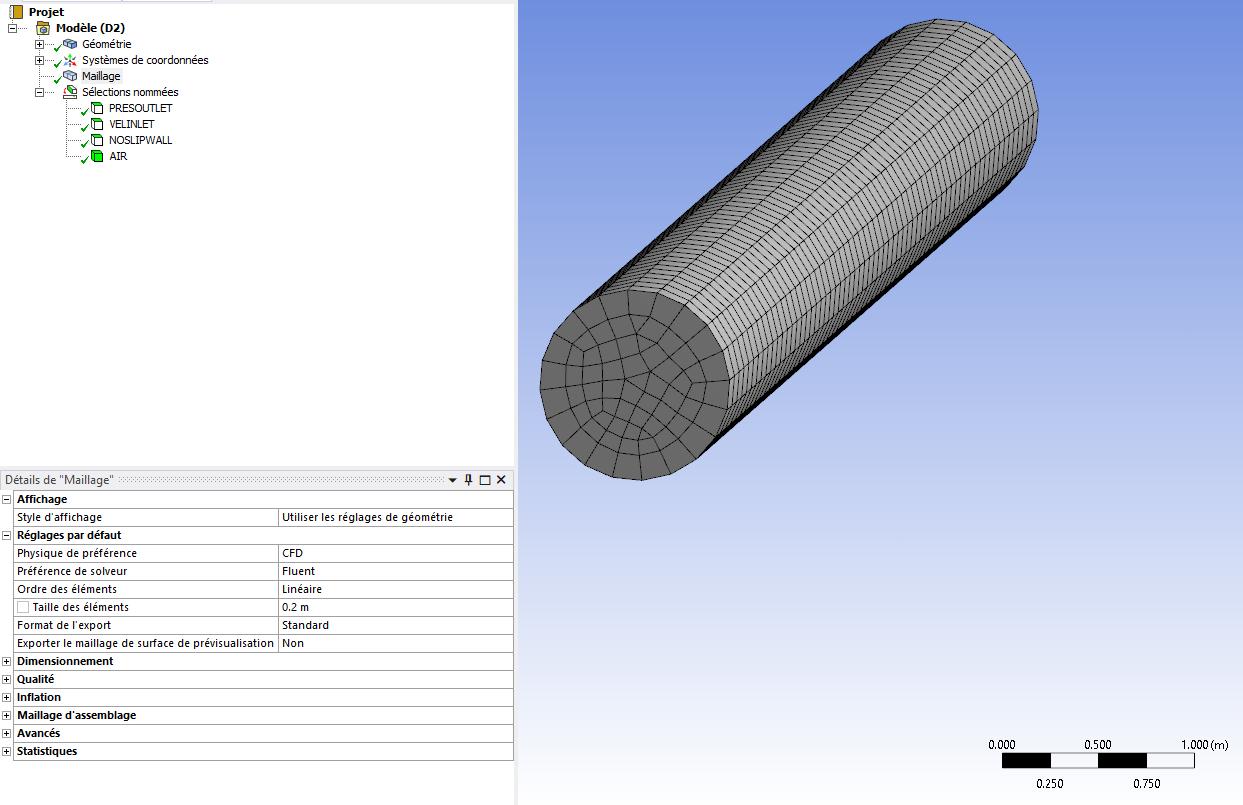

I can join my .xml file and my .cgns file if you want. It is a simple tube.
Thank you in advance to any one who may be able to give me some ideas to imprt Ansys mesh to Code_Saturne !

You can find original CGNS attached, and original case is Simple_Junction case without mesh. I have just removed original mesh ".des" I have replaced it by my CGNS mesh and rename boundary zones with Ansys named selections (I think it is the way...). CGNS attached are not converted by "cgnsupdate".

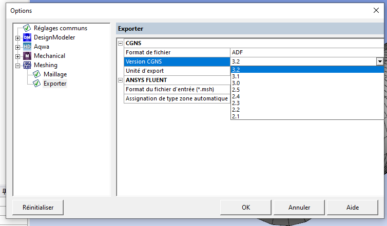

I have ever tried with 2.5 and 3.2 version, without success...

Did you reinstall code_saturne with CGNS 3.3, or simply change the output version in ANSYS ? In past versions at least, ANSYS meshing (or ICEM CFD at the time) would lie on the CGNS file version (by setting a different version number but not really using a different library version).
