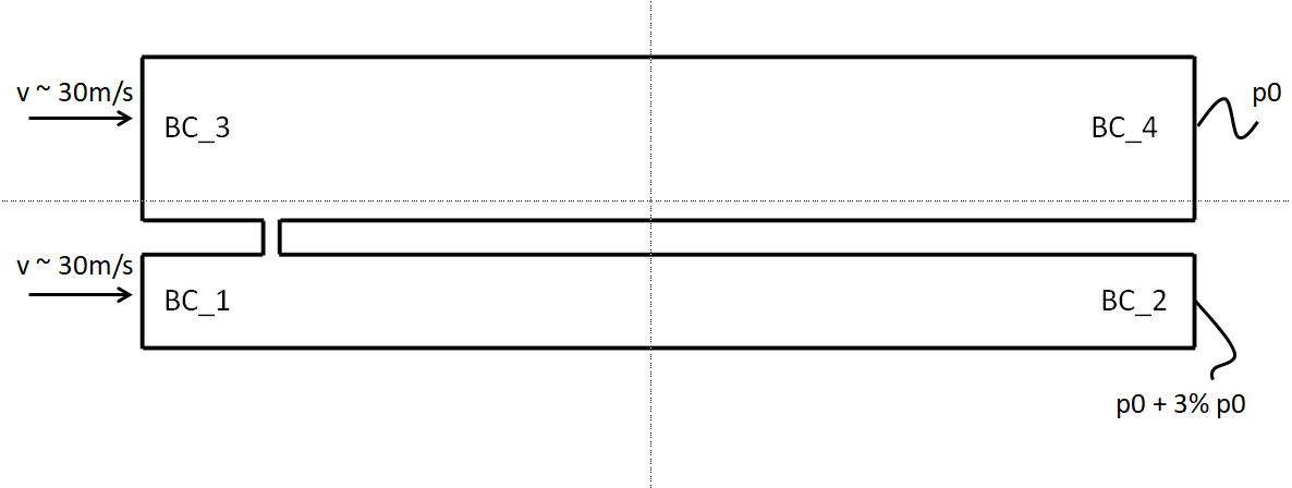

I have following simplified setup , two channels connected by a small pipe, while the static pressure drop between lower and upper channel is approx. 3%.
My Setup is BC_1/B_3: inlet with v = 30m/s, BC_4: outlet, BC_2: imposed P-Outlet with p = 1,03*p0. The reference pressure point is placed on a face at BC_4.
Contrary to my expectation the reduced pressure is lower at the exit of the lower channel (BC_2) than at the exit of the upper channel (BC_4)
Could you please point me in the right direction? What is wrong with my setup? Which is the misconception?

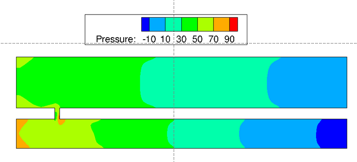

Following your suggestion I have changed BC_4 to an Imposed-P-Outlet, setting the Pressure to p = 1e5 and BC_2 to an imposed P-Outlet with p=1.1e5. This should force a pressure difference in the range of 10%.
Have look at the result Still not the expected pressure field.
Do you have some more hints?

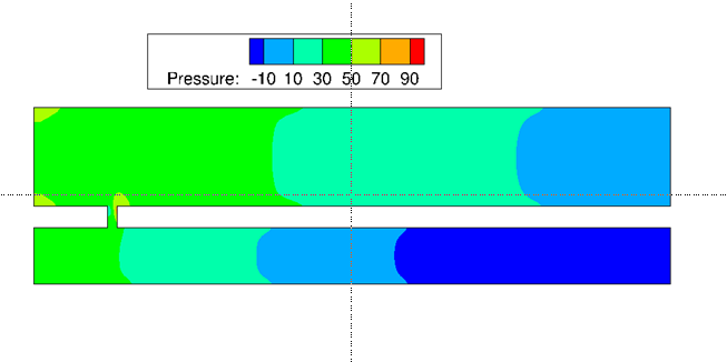

Maybe I didn't get it. What I want is that in the upper channel the pressure is lower than in the lower channel and the pressure difference is about 10% (setup in Test.zip).
What I get is, independant of the variable "pressure" or "total_pressure" that the pressure in the upper channel is larger.
Could you archive your results and post them? So I could compare your results with mine.

Re: Imposed P-Outlet
Thank you ,
seems to a problem of the code_saturne Version.
Comparing the parameter files I see no difference. Running your setup with my older 5.xx version i get the same false results using a 6.04 version i get the expected output.
thank you.
Kind regards
Ralf
