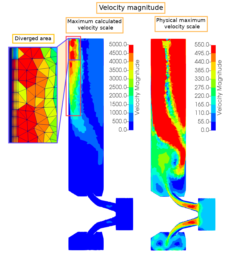

As an example I attach the picture with diverged velocity field if GT snail duct. You can see that the mesh is not good in prism-tetra transition zone but it's near impossible to have this transition ideal in practical cases. In the snail itself velocities rise up to ~500 m/s that is correct (I compared to CFX that is our mainstream tool at work). But, as you can see, velocity becomes unrealistic high at the top part of the duct and it will never converge with "usual" simple settings.

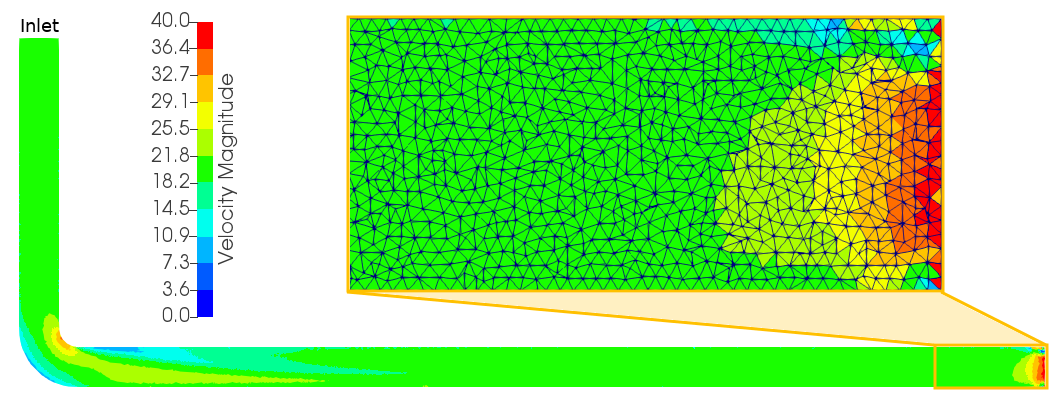

But I found one strange thing with the pipe bend case. To answer your question about the mesh effect I ran the same case without layers, there was the same issue with k-omega. But, what is very strange for me, id didn't disappeared when I switched to k-epsilon (without layers). Velocities rise to unrealistic values near the outlet (standard zero pressure outlet). It's a simple pipe, nothing special, and there are no parameters for outlet BC in Saturne GUI, other options are as usual, Saturne version is 6.0.0 (8 threads), divergence becomes obvious around iteration 160.
I attached a picture for the bend case with velocity profile after solution has diverged (k-omega without layers), solver log for the k-epsilon (simplest) variant (run_solver.log) and an XML file for the k-epsilon variant (Bend-G000-NL-KE.xml).
Tetra mesh for the bend case without layers: https://www.dropbox.com/s/0al0634150lft ... .cgns?dl=0
If you want to reproduce an issue with any turbulence model and mesh without layers, download the mesh, open appropriate XML file (now you have exact test XMLs for k-omega and k-epsilon variants), replace the mesh in case properties, let it iterate for 50...100 iterations with upwind scheme, then switch to SOLU with blend 0.8...1.0 for velocity (upwind for turbulence) and wait for approximately 150...300 iteration depending on the model you chose. You will see that periodical maximum velocity spikes appear, then maximum pressure (and velocity) constantly rises up to unrealistic values
it works for k-eps without layers but does not work for k-w SST with layers
Yes.

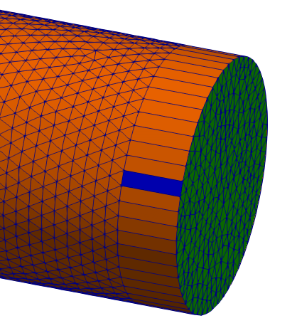

Ivan, I just tried to add the othogonal layer for the outlet using "Mesh extrusion" GUI feature for the OUT face group. Extrusion itself works but when the solver starts it fails because of incorrect boundary type:
The workflow is very simple: use "Bend-G000-NL-KE.xml" case, add mesh extrusion, set OUT as selector. I attached the solver log. I think it's because OUT group is now includes interior faces:
How can I work it around?

I checked the error output closer. First, in ERROR.case, there is a couple of quad faces at the outlet part created by the Mesh extrusion feature (Mesh => Preprocessing => Other => Mesh extrusion) that have BC error. I attached the picture from ParaView (Bend-Extrusion-Error.png), faces with BC error form the blue stripe (actually there are two faces, I see it with the Multiblock Inspector if I select "Faces with B.C. error"). Also, in the listing, I see that the solver has added 106 faces to boundary_faces zone but only 104 faces to WallSide group (originally, in the running case, it's one of two pipe wall face groups: one wall group is located around the bend, second is at straight parts, for different roughness in our model case). It seems that the solver, although smart enough to modify boundaries, "forgets" about these two faces on extruded part so they has no parameters set and become errornous BCs. Looks like a bug... Could you, please, check this at your side to confirm? I provided the case XML and tetra mesh, you can test on any machine because the mesh is very small.
Yes, if you disable mesh extrusion, you will get divergence at the outlet, but the case will run without BC problems, so the mesh itself is correct. I checked it just now, the only thing I changed was disabled extrusion and the solver started fine.
Update
I tried to play around with extrusion parameters (reduce cell size and number of extrusion layers from 2 to 1), the result is the same, you can see it on the picture №2 (Bend-Extrusion-Error-2.png).
Update
