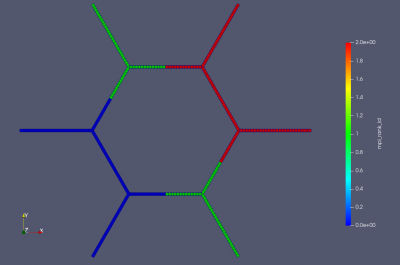

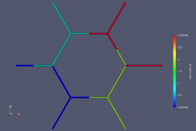

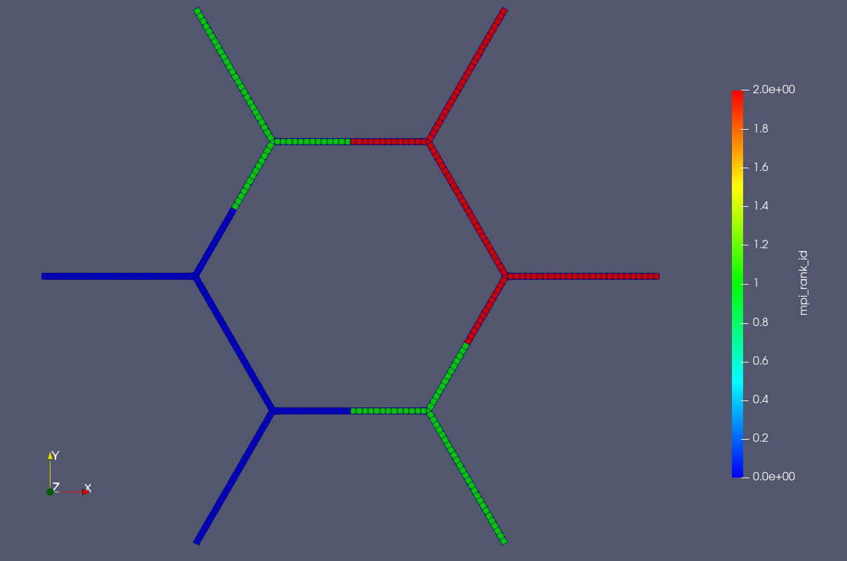

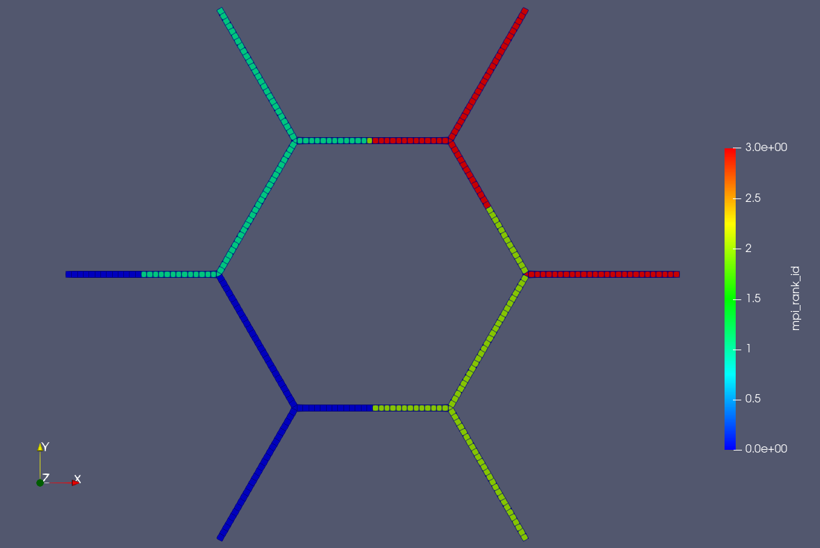

Re: Running parallel calculation from Terminal
Hello again,
I join you here the MPI rank IDs within the same geometry for 3 and 4 processors. In the last case, it seems that the geometry is not symmetrically cut which may explain the problem.
Thank you in advance for your attention.
So_nuc
So_nuc
