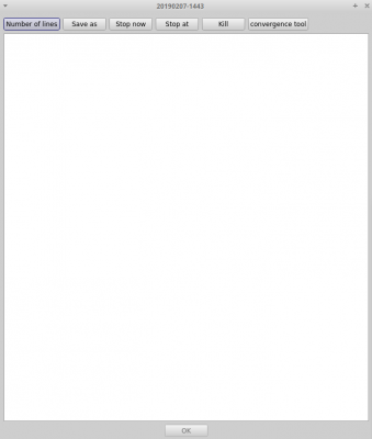

I would like to start a calculation thanks to the interface Code_saturne gui but when I do "Start calculation" (after saving my case), nothing happens except an empty white page with some buttons.
I tried several versions of Code_saturne and I also tried to run the file SCRIPTS/runcase and it worked, but with the new version 5.3.2, I saw that we could check the convergence thanks to the interface and I can't try this without starting the calculation using the interface (?), so is there anybody here who had this problem and succeeded to solve it ?

For the issue, we have not solved it yet because it is difficult to reproduce. So I am interested in details on your installation and system.

I can add an information, maybe it can help :
I just installed the version 4.0.9 of Code_Saturne and in the interface, when I want to check the mesh, I can do it launching in the gui (Calculation environment > Mesh Quality criteria > Check mesh) the button, it works !
But even in this version, the button "Start calculation" just open a window without starting any calculation.
Noam
