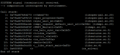

I've "succeed" one time to install v5.1.5 (on NFS shared folder), with the auto install script.
But the user reported a SIGTERM signal (error.png).
So, I tried to compile others flavors: first time stable version v5.0.9, v5.0.9 debug, v5.3.0, v5.1.5 debug with the auto install script, and now manually.

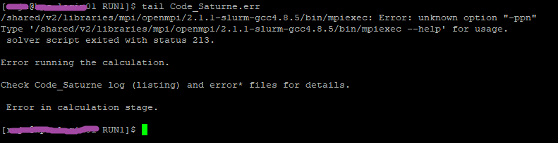

sorry for the delay (admin life...)
Here is the last error reported by the user (error2.png)
Seems simple, I'll try to find on my side too.

For OpenMPI, using SLURM, on at least one of our systems, we set
mpiexec_n_per_node =
(empty string)
in etc/code_saturne.cfg so as to avoid the automatic -ppn setting. This should work here also. Though I don't understand why it appears if you did not set it (in bin/cs_exec_environment.py, it is set if the detected mpiexec is Hydra, from MPICH, so should not appear here).
FredH

thanks for the quick answer, the ppn is removed now.
