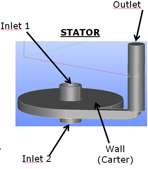

Dear experts,
I'm currently simulating a flow through a centrifugal pump. I would like to compute the difference of total pressure between the outlet and the inlets (in my case there are two inlets).
The total pressure is defined by TotalPressure=Pressure+0.5*density*mag(Velocity)²
Is it possible to compute such a variable directly in Code_Saturne or should I use Paraview ?
Another question : is it possible to compute the average value of variable (e.g. pressure) over a boundary surface (e.g. inlet) ?
Please find enclosed a picture of the pump.
Thank you in advance for your answers,
Valentin
