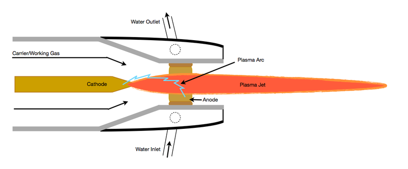

Non-transferred arc is the arc like in the attached picture.
Rodion
