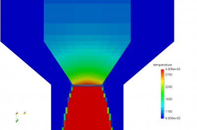

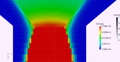

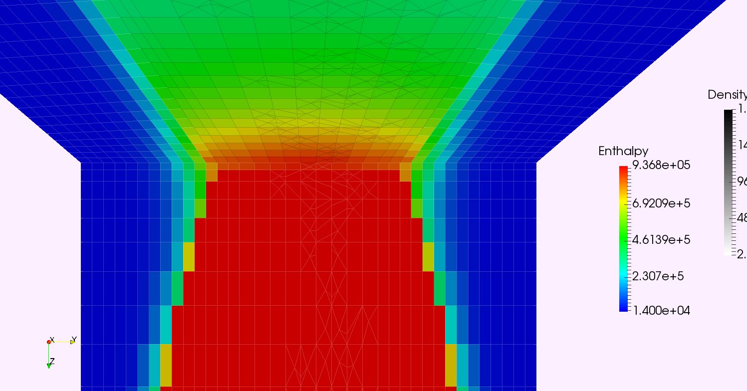

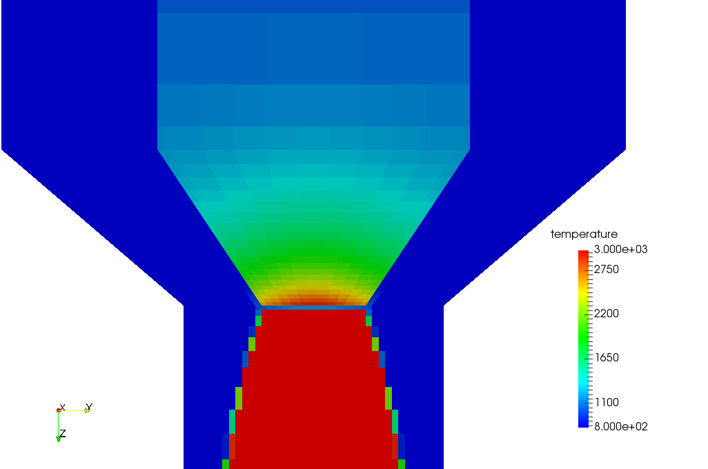

Please find pictures with enthalpy and temperature distributions attached.
The question is: how can turn thermal variable from enthalpy to temperature for electric arc simulation or how can I improve the heat flux calculation at the interface of metal and fluid?

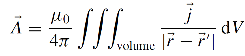

2. I want to integrate electric current through the whole domain as it is described in the formula below. I think paragv is what I need. Thanks a lot, Yvan!
