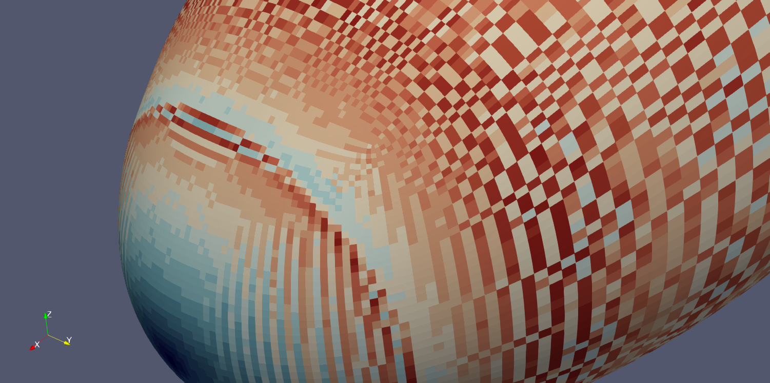

I can observe that the wall shear stress (field Shear_Stress) has strange behavior (checkboarding effect, see attached picture).
I would like to know if any of CS users or developpers have already faced this problem and what could be the cause of this patterns ?

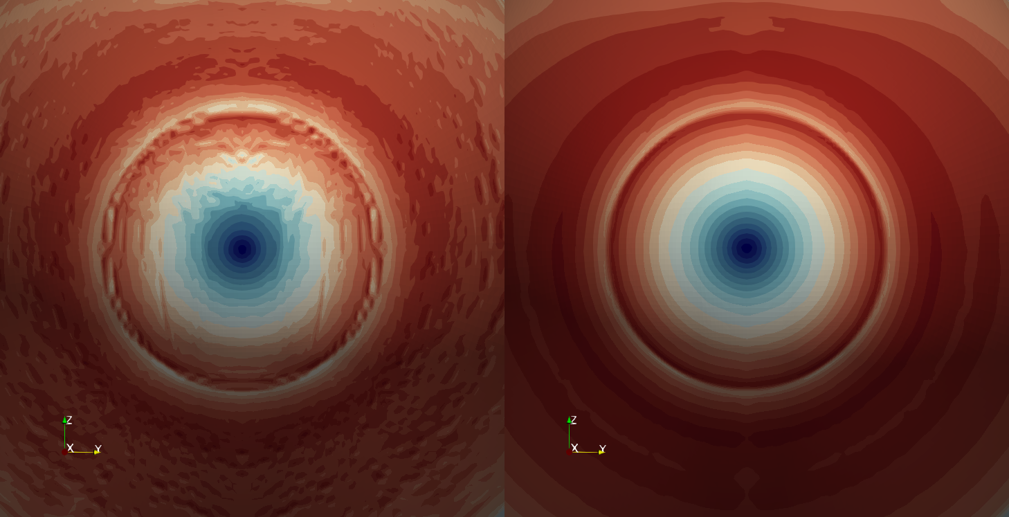

Could you try also using a "cell data to point data" filter ?
Yes, it slightly improves, but for pure Hex structured mesh, i didn't expected to need this. And still with this filter, results does not look as physical as it should be (see attach picture comp.png with comparison for "cell data to point data" filter for cs (left) and other code (right)

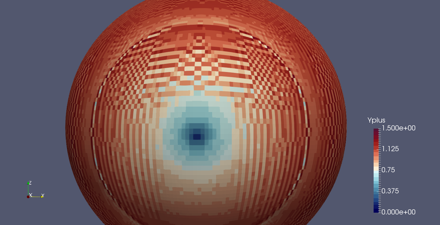

what values of y+ do you obtain ?
typically around 1 where checkerboarding is observed (see attached picture)

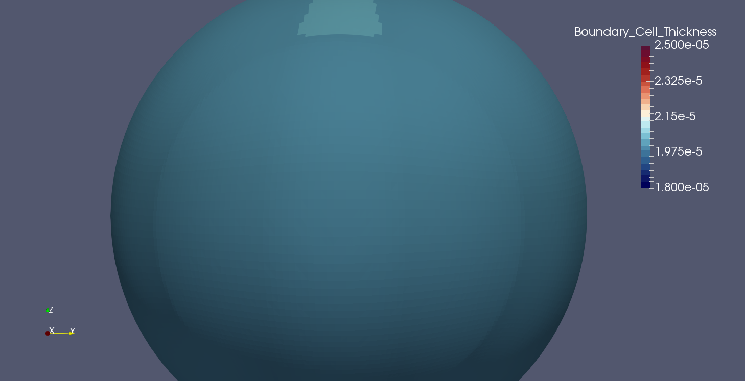

visualizing the boundary cell thickness
see attached picture, no checkerboarding seen at this level
