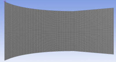

I am completely new to Code_Saturne and I am struggling with my first model. I am running Code-Saturne version 4.3.1 on a windows 7 operating system and so far, for the setup I have just used the GUI.
I am trying to simulate a two-dimensional flow through a laval nozzle shape. Inlet pressure is 4.98 bar, inlet temperature 462 K and the speed equals 118.90 m/s (Ma*_inlet = 0.3). The outlet conditions are: Ma*_outlet = 1.5, p_outlet = p_ambience = 101325 Pa, T_outlet = T_ambience = 293.15 K.
I don’t understand why and how I have to initialize i.e. pressure and density. In case I set their values to zero I receive the following error message:
../../../src/cfbl/cs_cf_thermo.c:284: Fatal error.
Error in thermodynamics computations for compressible flows
Negative values of the density were encountered in 5936 cells.
If I initialize the pressure and density with p_ambience and density_ambience = 1.204 kg/m^3 I get a different error message.
The xml file as well as the error message and a picture of the meshed geometry are attached to this post.

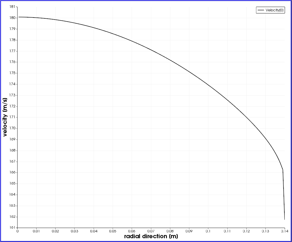

With respect to your question about the no-slip condition (sent in mp) that is not fulfilled, can you give some details?
Erwan.

Good morning Erwan,
Thank you for replying. I changed my setup a little bit and attached the xml file to this post.
I am wondering why I can’t see the no-slip condition at the wall. I chose the k-ω-SST turbulence model and the smooth wall boundary condition and expected the velocity at the wall to be zero. I refined the mesh size but it didn’t help much. You can find the velocity profile at the inlet as well as the mesh in the attachments, too. Can you please help me with this issue?
Chris
Chris

- Posts: 4272
Re: Laval nozzle
I'm not sure, but k-omega is not a low-Reynolds model, and in Code_Saturne, the postprocessing output is the value at boundary cells, not truly at the boundary face, so your result is probably not surprising.
I'll check.
I'll check.
