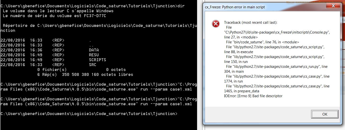

I would like to use CS without graphic display to perform a parametric optimization with windows 7 64bits.
I try with the windows command prompt:
“code_saturne.exe run –param text.xml”
But there is an execution error
Thanks
Guillaume

Do you start the execution from inside a case directory ?
The "code_saturne run" command assumes you are in a case directory (otherwise, you need to pass it the additional --case parameter).

I launch the code_saturne command in the case directory (See as an attachement).
Guillaume

I would need to check the exact line matching the error message you have, but I won't be able to do it before next week.
Maybe someone else can look at this, or it will need to wait until next week.

Could you post the case and mesh files in order to check It?
Luciano
