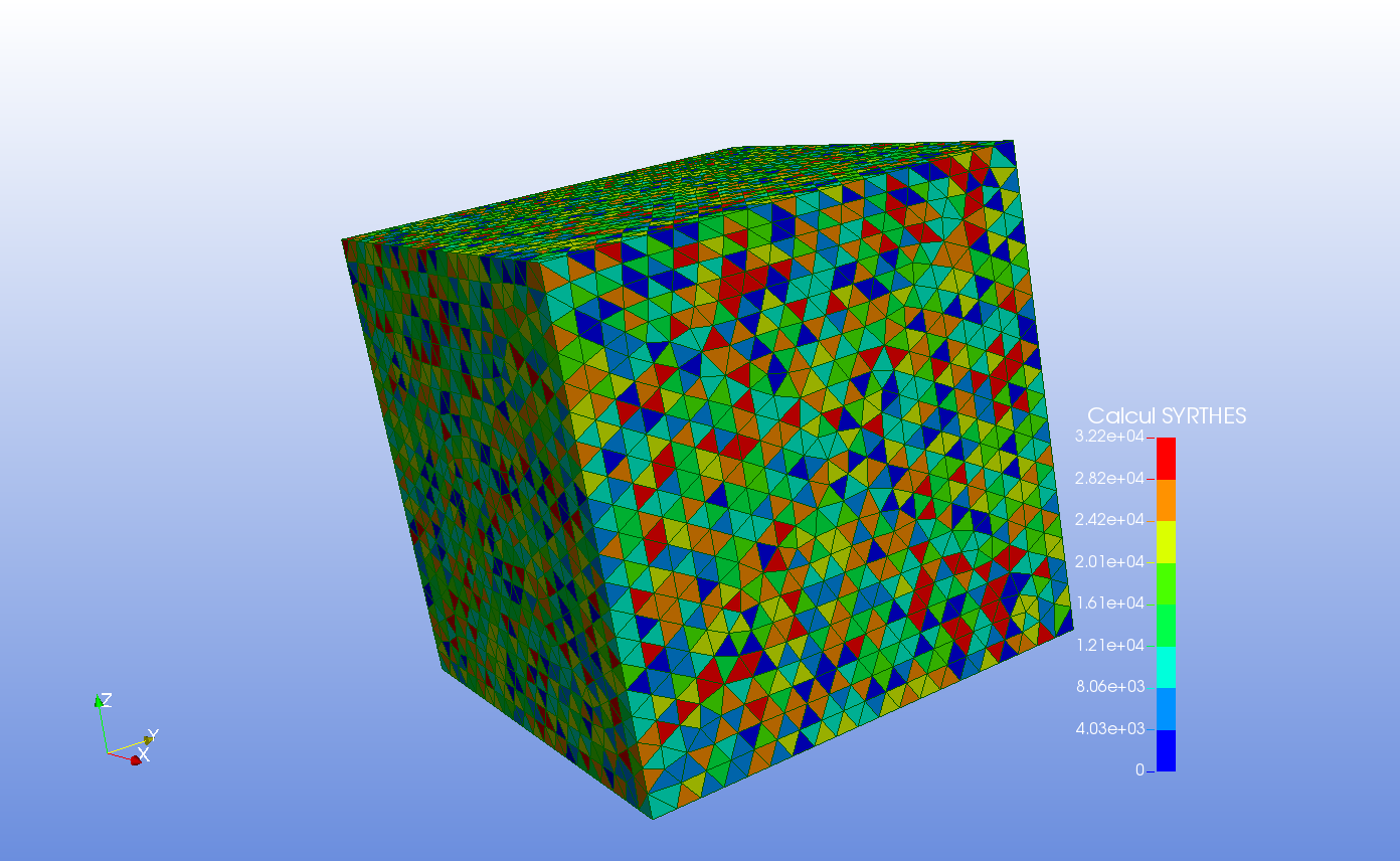

When I choose 3D heat flux field in the Syrthes GUI, there is an extra result in the MED file, named "Calcul SYRTHES" besides the temperature field. If I don't mark the 3D heat flux field, this result is not present, so we think this is the flux calculation for obvious reasons.
When I plot this, it does not make any sense. See fluxSyrthes.png atached. Besides, it has only one magnitude, and I would expect magnitude and three components, X, Y, Z.

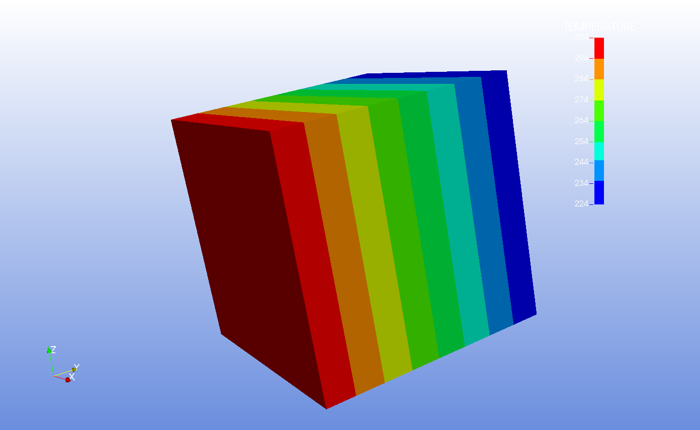

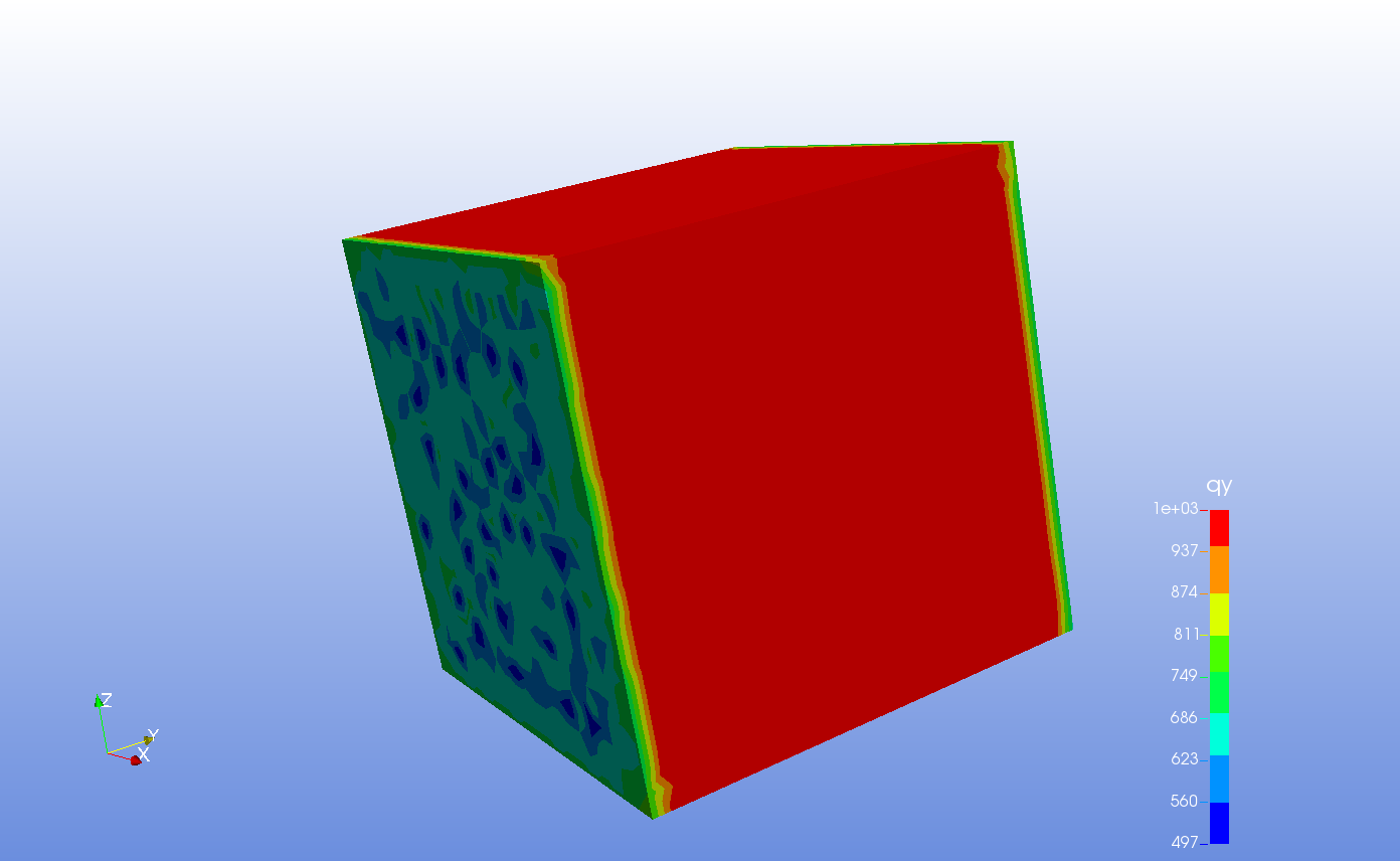

The problem is very symple, cube with all sides adiabatic, except two opposite faces, one with 1000 W/m² and the other with convection: h=5, Text=25ºC. Therefore, the heat flux must have only component in one axis, in this case the Y axis, being zero in the other two. The temperature field attached in: temperatureField.png.
If I compute the flux with Paraview, it's ok but near the borders, results are very bad computed, I think because the interpolation lacks backward or forward node, depending on the side of the cube: see attachment: fluxParavis.png.
I can live with the paravis calculated flux for internal purposes but I can't show this kind of result in a conference or somewhere else.

The computation with ParaView probably assumes Neumann boundary conditions for the gradient, explaining the boundary issues, so there is no good solution for that.
Do you postprocess using a MED or EnSight format ? It seems (looking at the sources) that Syrthes outputs 3 different fields for the flux (one for each component x, y, z), which you should be able to assemble as a vector using the calculator under ParaView.

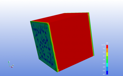

The computation within paraview, Filter: Gradient, uses central differences, so at the boundaries, the computation it's not very good, they should use there backward and forward differences.
In any case, I found how to compute the flux properly. It was there, we didn't realized but it was there sorry for wasting your time with this question. I'll report here how to do it, just in case someone else find it useful. So there we go: How to compute heat flux components in Syrthes and have this data available for Paraview postprocessing:
When you tick in the syrthes GUI the 3D/2D Heat Flux Fields, it is stored in results.add, assuming "results" is the keyword selected. So this information is not in the results.res or results.rdt. And therefore, it is not converted directly to MED or Ensight format and put in the POST directory. You have to do so manually. For that, you need to have the mesh.syr file and results.add in the same directory and issue the following command:
syrthes4med30 -m mesh.syr -r results.add -o flux.med, where the flux is stored in flux.med ready to be processed in Paraview, because it is MED compatible format. That's it.
