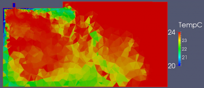

I'm using for my CFD studies the software Code_saturne for calculations and "Paraview" (4.0.1) for the rendering.
When I see the results (see picture)
The view is not smoothed but with rectangles/triangles corresponding to the meshing.
I have tested the filter in Paraview "Smooth" but the view is still with rectangles/triangles and the filter "smooth" modified the results (the interpolations are not corrects).
Do you know, how can I a smoothed view for my results ?
Thanks,

Yes, use the "cell data to point data" filter (with ParaView < 5, you need it to generate vectors and streamlines also)

Thanks, very useful.
