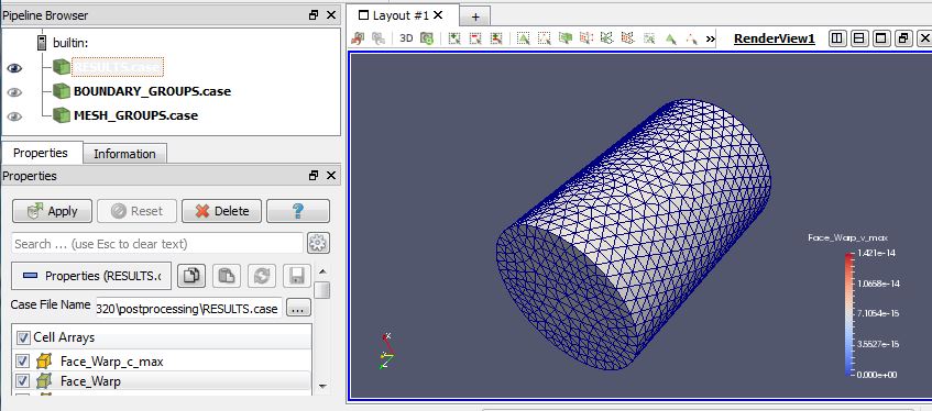

Re: start calculation -> nothing happens

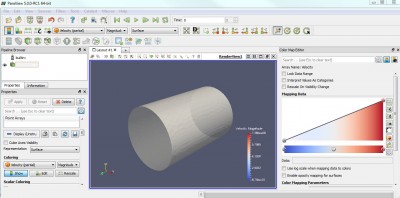

I attach the result folder.
I have then installed a standalone PARAVIEW for visualization ( the PARAVIEW installed with CODE SATURNE doesn't seem to work )
I can visualize the RESULT.case with PARAVIEW but i wonder if anything 'fluid' has been computed ??

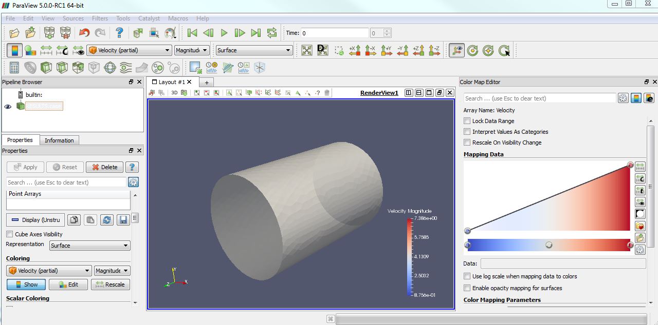

Thanks Yvan
I have performed a standard run now. ( attached folder )
In PARAVIEW the pressure, velocity ... are selectable.
If I choose velocity a color scale is displayed and take into account the inlet velocity I set in CODE SATURNE.
But the colors are not displayed in the figure. I just can see the shape of my cylinder even after having selected 'velocity' and 'apply'.
I will open a new topic for this.
Gregory
Gregory
- 20151215-1056.zip
- (891.16 KiB) Downloaded 313 times
- Posts: 48
In paraView, to visualise the fluid volume only (and not the boundary mesh) you should use filter->alphabetical->extract block
Then you can select the fluid domain only et click on apply.
You will be allowed to visualise pressure, velocity, etc
Best regards
Martin
Best regards
Martin

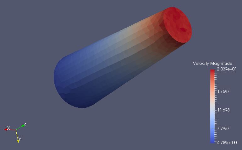

Thanks. The fluid visualization is ok with this filter.
File>Open result.case
Apply
Filter>Alphabetical>Extract Block
Check "Fluid domain"
Choose data in the scrolling menu in the "Active variable controls" toolbar
Best regards
Gregory
Apply
Best regards
Gregory

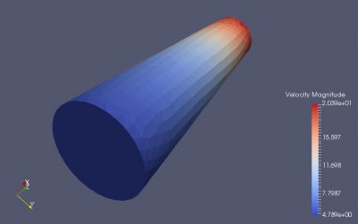

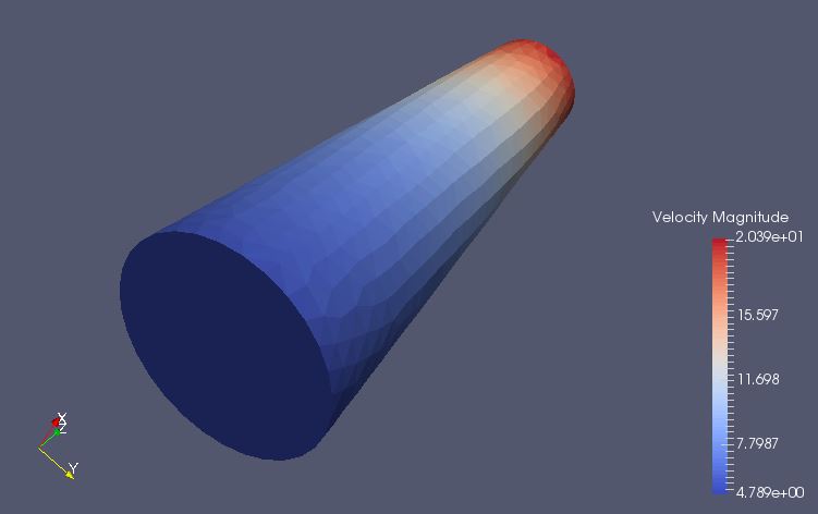

( here is the result with a truncated cone )
Gregory
Gregory

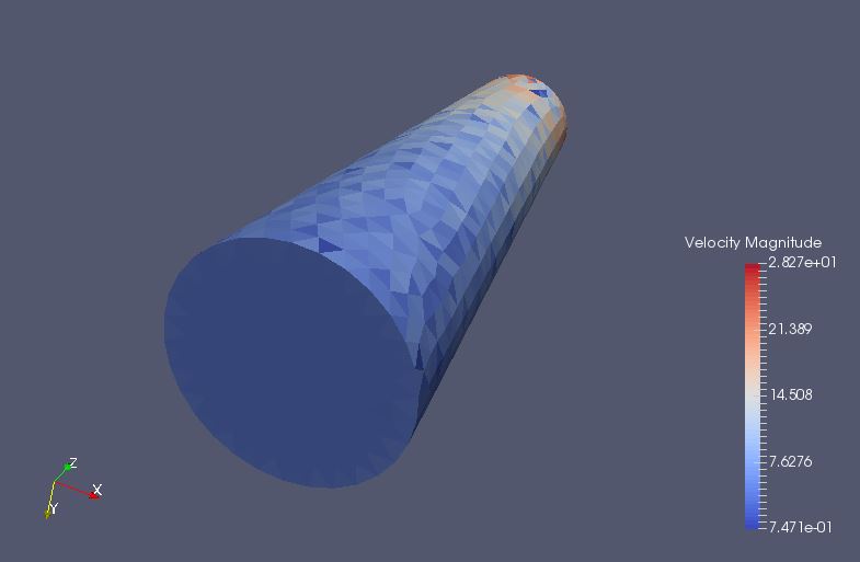

When using a tetra mesh, we advice to activate "least square with extended neighbourhood" gradient calculation method in the GUI (or set: imrgra=2 in cs_user_parameters.f90).
Best regards
Martin
Best regards
Martin

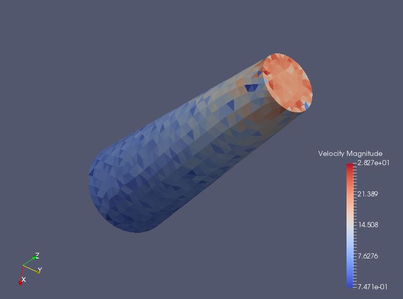

Thanks Martin
Actually the result is more homogeneous with the least square with extended neighbourhood method.
Best regards
Gregory
Best regards
Gregory
