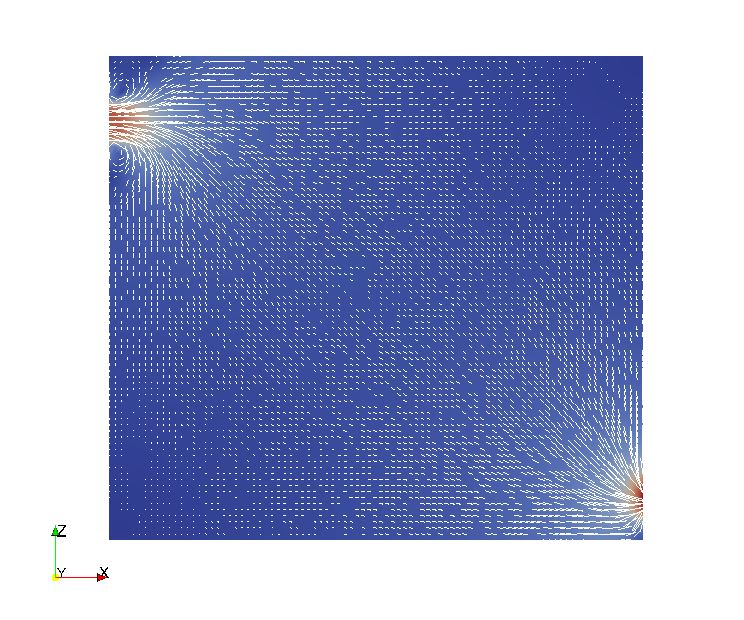

I have a mass flow balance issue in a simple case. My mesh is hexahedral and regular. I put an inlet condition for a number of boundary faces on the up left of the domain and an outlet condition for an identical number of boundary faces on the down right of the domain (see associated picture cas.jpg, color what you see is velocity).
