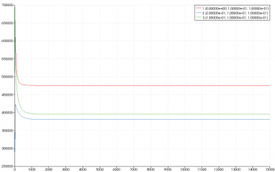

I have monitor points (to check convergence) at the inlet, outlet and in-between. Here are the results up to 15 000 iterations:
Monitoring points - Pressure results.
As you can see, the pressure appears to have converged.
The inlet pressure (red line - 1) looks off despite the monitoring point being exactly at the x value at the inlet. I agree that this has something to do with averaging with the downstream values (which decreases along the domain) but it shouldn't be like this. Afer all, the applied boundary condition is exactly at the same location as the monitoring point - shouldn't these values agree?
A bigger problem though is the outlet pressure (blue line -2). How can it be ~380 000 Pa if the applied outlet pressure boundary condition is 250 000 Pa? This isn't even close.

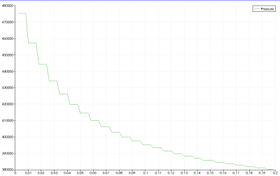

Here is a plot of pressure along X in the domain to see what is going on:
Pressure along X in center of domain.
Yeah... no way there is a 250 000 Pa outlet pressure.
So what exactly is going on here?
Stefan

About the pressure at the inlet, the value doesn't seem strange actually since, as I said, what you see is the nearest cell center value and not the value on the boundary.
Erwan.

Since you use an imposed inlet condition, the Dirichlet value of the pressure at the inlet is really what you give, whereas at the outlet, by using the subsonic outlet boundary condition, you enable the resolution of a Rieman problem (in which the pressure you give is imposed as "right" state, and the last cell values are imposed as "left" state). The aim of this is to find in which state your boundary is (possibly the left state (supersonic outlet), an intermediary state (expansion wave for example), etc...).
The subroutine solving this problem is implemented in the file src/cfbl/cfther.f90 and is called in src/cfbl/cfxtcl.f90 (l.514),
call cf_thermo_subsonic_outlet_bc(bval, ifac)
If you want to see the value of the pressure right at the boundary, you can it print out as follows
write(nfecra,*) 'pressure at outlet boundary face', ifac, ': ', bval(ipr,ifac)
(insert this code line just after the call).
Hope this helps,
Erwan.
