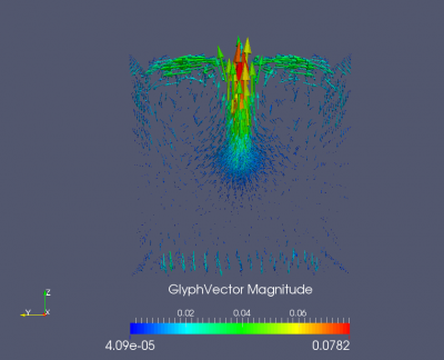

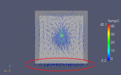

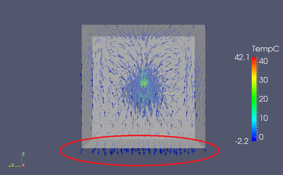

BUT: Nevertheless: I am still getting these weird velocity vectors at the boundary walls... The velocity should be PARALLEL, and not perpendicular...
I already tried the following: using an inlet and force the velocity at the bound to be 0m/s in the perpendicular direction and in some other arbitrary angle. Neither of the two helped.
I found out that I could also use the SIMPLE algorithm in the fluid-domain but this has not been the issue.
Then I changed the direction of the gravity (pointing in a direction with z and y component and a length of the usual 9.81m/s^2). This lead to the change in direction of the "plume", but even here: The velocity at the boundary is WRONG. I do not have walls which were supposed to be leaky...
Thus, if I use the streamline-tool in paraview, it shows that not only right at the boundary the velocity has a vector pointing in the wrong direction, but also the interpolation between the realm with the main convection cell is taking place and the boundary is wrong (there is no boundary layer in the result / no crust which I could snip off in the post-processing in paraview). -> boundary condition at the wall is buggy!

Concerning the near wall velocity vector problem, I haven't come across this one before. Is it not just a question of visualisation and the Paraview process for plotting vectors? The process I currently use in Paraview to plot vectors (in the volume or on a section) is as follows:
1) Convert cell data to point data from the imported results file
2) Extract the fluid domain from the point data
3) Plot the vectors using glyph
Hence when you plot vectors, it would seem that one is only plotting the fluid domain data (no boundary data) at the nodes of the mesh which might explain why you see vectors going into the wall boundary.
Another line of thought is how refined is your mesh in the near wall regions?

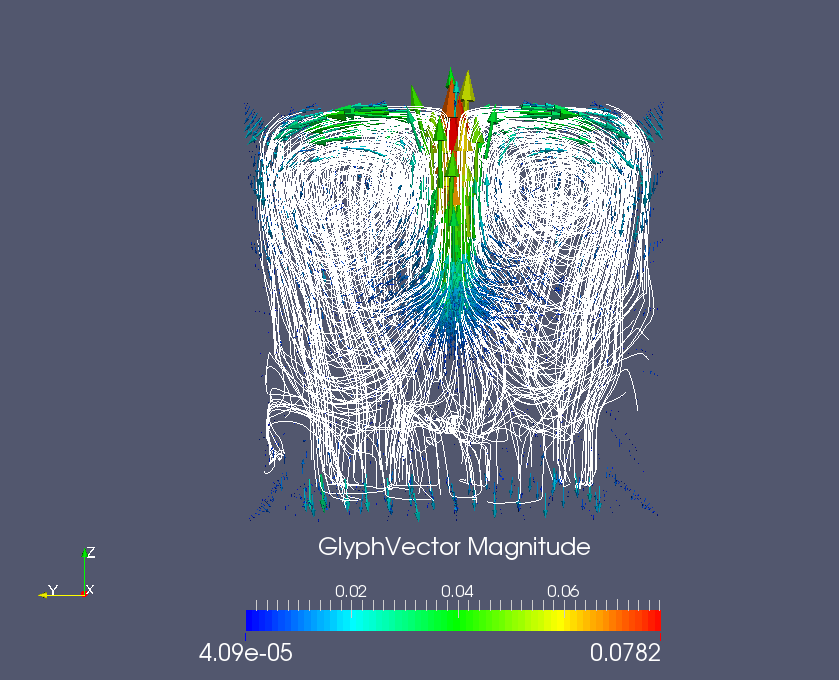

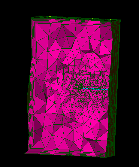

Although I added the viscous layer hypothesis in my mesh (FluidMeshWithViscousLayer.png), I still get the velocity-error at the bottom (fluid_Velocity_Error.png).
This may also be seen in the Streamlines (fluid_Velocity_ErrorStreamlines.png)
BTW: In paraview, it is only possible to get the velocity vectors iff you decompose the data into the fluid block and then you may recalculate the values from the cell-center to the nodes (what is much nicer, because then data is interpolated).
In order to get rid of the block selection, one may chose in code-saturne to leave out the boundaries and the intermediate layer to syrthes. -> only one block remains which is unique -> paraview knows what to do.
