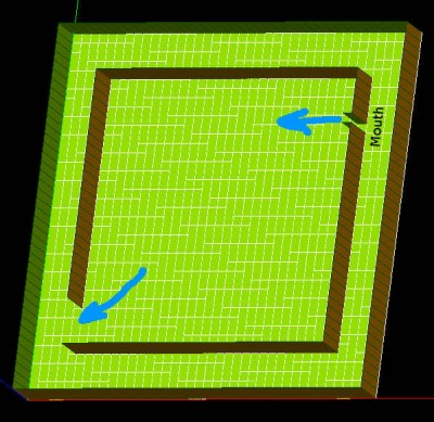

Here is the mesh (without the upper symmetry wall):
Mesh (without upper symmetry wall)
the flow of cooler air enters the inner chamber through the mouth. The very same air flows back in through the outside duct.

and here is the simulation:
This simulation is done with rtpa applied for velocity and temperature to the cell located inside the lips of the mouth, this in the cs_user_boundary_conditions.f90
Yvan Fournier wrote:Hello,
There is no icodl/rcodcl for interior faces, so you cannot do this, but defining thin walls transforms interior faces to boundary faces (with minor issues for the volume post processing, which is not aware of the change), so you can use icodcl/rcodcl for thin wall faces.
I think that my problem is a bit different since I want a closed air circuit. I believe that a boundary inlet cannot flow back in the very same inside air ...

Posted: Tue Sep 30, 2014 8:36 pm
by Yvan Fournier
I assume your closed air circuit has some simplifications (pump not detailed), or uses natural convection only (in which case you do not need to force anything, but must have a fine mesh and adapted turbulence models so as to get the most precise heat transfer you can).
By your image, you probably do not strictly need an inlet/outlet (or thin walls) : if you want to force a given velocity at a certain point, the best solution is to "measure" the flow through the area of interest (cells or faces), and use a use source term (with feedback based on the measure) to drive the flow you want. The examples in the user source terms user subroutines are a bit minimalist, but are hopefully enough. Otherwise, if you do not manage to find examples in this forum, I can send you one later.
To replace you thin walls by a mesh "opening" without editing the mesh, just use mesh joining with the same selection criteria you used for thin walls.
You can use separate (independent) source terms for velocity and temperature if you need both.
