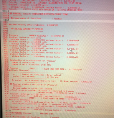

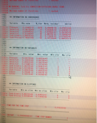

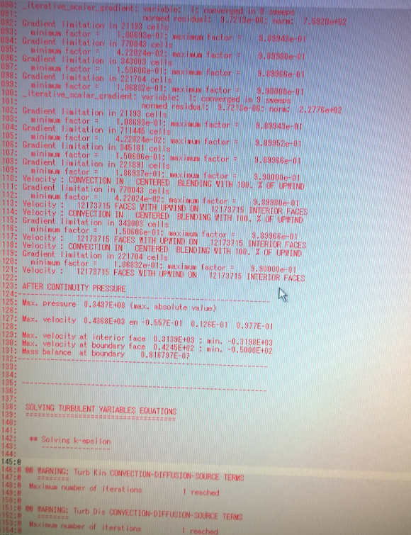

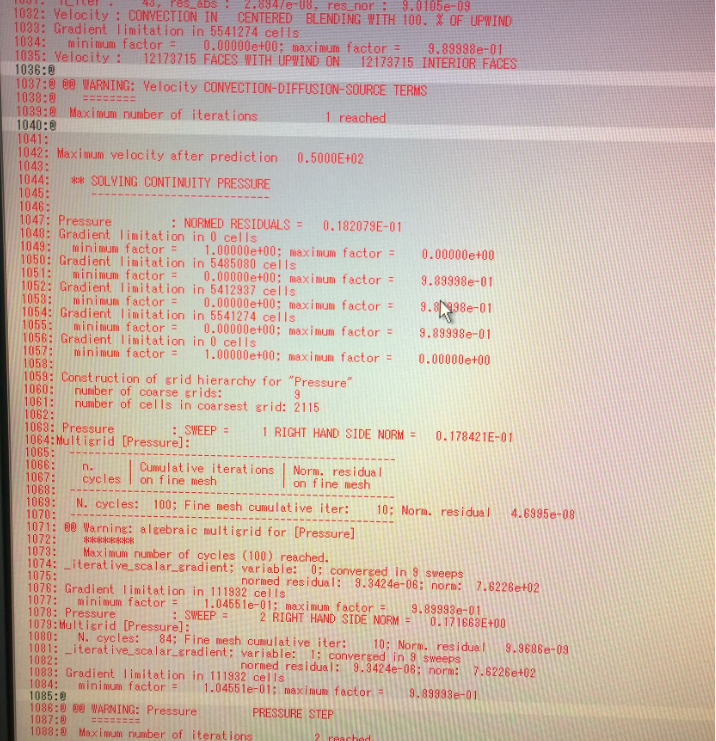

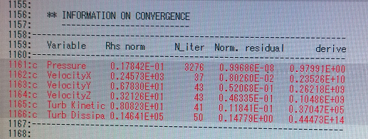

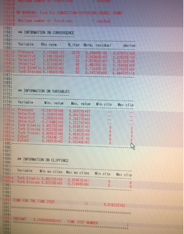

Thanks very much, but how to do this without GUI?
In my case, the value of pressure and vilocity are up to E+20 after some iterative .Obviously,ti is wrong.But all of this haven't appear in saturne2.0.
The attachment are some information of listing in saturne3.0
Yuan Huang

- Posts: 4299
Re: A question about saturne3.0
You relaxation factors are not quite the same, and gradient reconstruction options may change.
As the gradient converges badly on 2.0, I assume your mesh is not too pretty.
I am not sure about other aspects, but there may be bugs in 3.1, which is not maintained anymore.
For a "safe" comparison, I recommend using 3.0 (stable) instead of 3.1. If you want the latest features, 3.2 and 3.3 will be maintained until 4.0 is released early 2015 (4.0 beta will be branched in october, so early testing will be possible).
