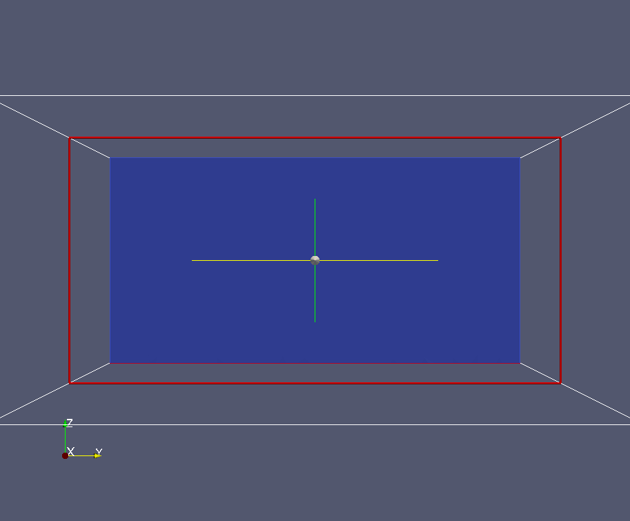

I see no heat transfer between wall and domain, why?
  • I did several simulations using:
    Turbulence: Laminar, LES
    Boundary: Smooth Wall, Rough Wall
    Type: Prescribed Value, Coefficient
    30 iterations, each 0.05s
CS version 3.1
Case file: https://www.dropbox.com/sh/1hyrhqvzpien77c/LZhu88LVcX top right click download -> as zip
Regards and thanks for help
