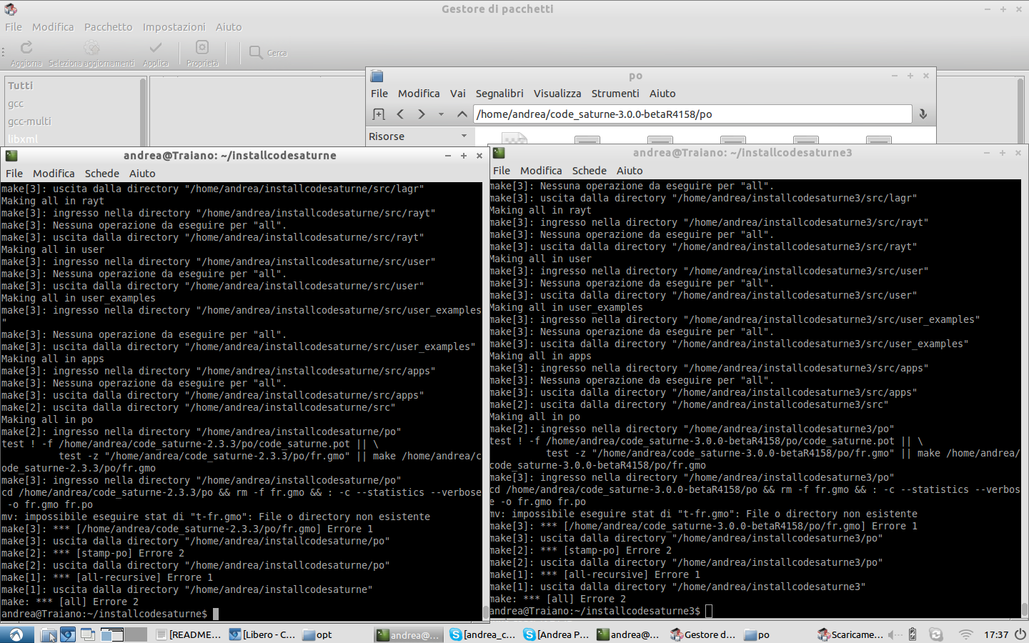

During the installation, after the configure, the command make bring me in the situation visible in the attach.
The situation it's the same in the left (code saturne v2.3) and in the right (code saturne v3 beta) of the screenshot.
Anybody could help me?

Could you post your config.log also ?
Did you configure the code from a separate build directory (recommended) ?

Re: Code Saturne v2.3 and 3 beta installation problem on lub
This seems strange. Does the "/home/andrea/code_saturne-3.0.0-beta4158/po/fr.gmo" file exist in your build directory ? Do you have "gettext" installed on your machine (things should work without it, but as it is a rare case, it might not be tested enough)?
no fr.gmo there isn't in the directory but exist a file called fr.po
gettext is regulary installed.

- Posts: 4303
The .gmo file should exist when you uncompress the tarball. Could you de-tar the code_saturne-3.0.0-betaR4129.tar.gz, replacing your previous code_saturne-3.0.0-betaR4129 directory, and see if the file exists after that.
If it exists, does running "make" now work, or does it remove that file ?
If it fails, although it is not my favorite solution by far, do you get any other errors when running "make -k" instead of "make" ?

biko86
there was a misunderstanding.
When i uncompress the tarball fr.po is present in /home/andrea/code_saturne-3.0.0-beta4158/po
but there wasn't in the directory where i ran the configure.
in the meantime, i really don't know what i did, but at the moment Code Saturne3 starts regularly.
Maybe it's due to installation of some library like libicu-dev or freeglut3 otherwise i've no idea.
