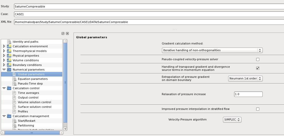

Following the installation of Code Saturne 2.3.1, i re-ran a test that used to run well on Saturne 2.0.4
I may have found 1 issue:
-> everything runs fine when using "iterative handling of non-orthogonalities" for the gradient calculation method (albeit a message reading "run_solver.sh[10]: module: not found [No such file or directory]") but the calculation can not run when using all the methods with "least squares method"
I have this message in the listing:
"/tmp/saturne-2.3.1/installer/code_saturne-2.3.1/src/mesh/cs_mesh_quantities.c:1663: Fatal error.
The option selection indicator for the cocg computation
for vector gradients can take the following values:
0: do not compute cocg dimensionless matrices
1: compute cocg matrices
and not 0."
I am attaching the listing of a calculation that runs OK (***-1312) and calculations that doesn't run (***-1401)
Have a nice day
