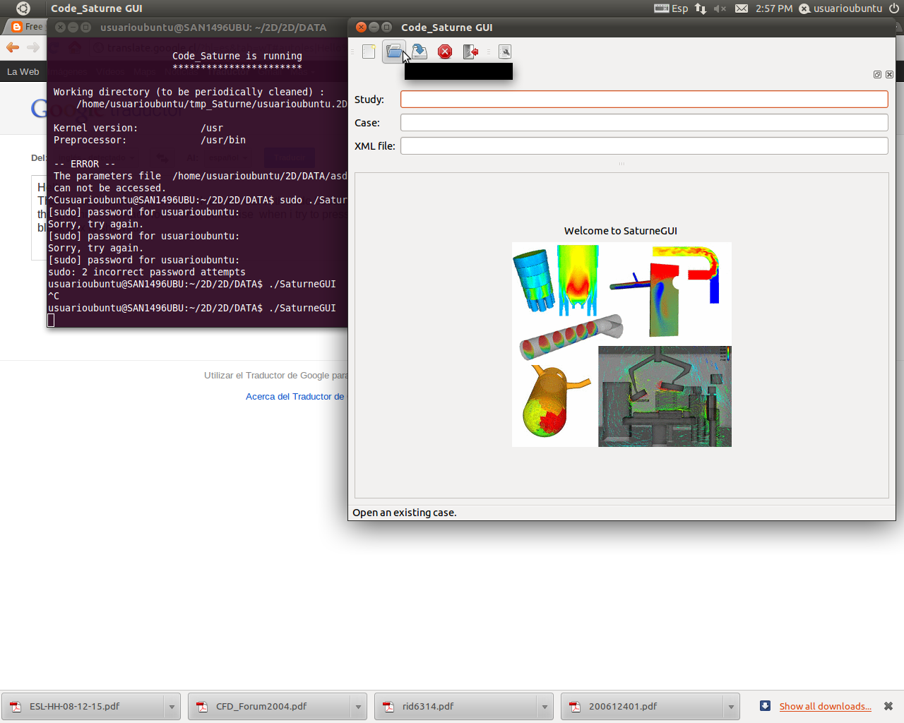

I run the Gui using sudo because this make that the graphical interface looks fine, otherwise when i try to press the icons a little black box is showed. (take a look of the screenshots)

I have the explanation for the black boxes (I had them on Ubuntu also): they are simply due to the choice of color/background color in the Ubuntu default gtk themes (the Code_Saturne GUI uses qt4, and always uses black text, so we might have to find an improvement there).
In any case, using a slightly lighter background for help bubbles will solve that problem (sudo/root probably uses a slightly different theme).
I suggest then running without sudo, and checking if you still have the same problem.
