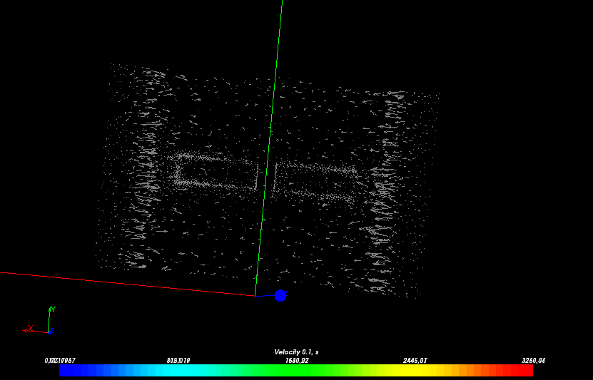

If you show some pictures of the flow-field I might be able to suggest something depending on what the problem is.
Re: turbine modelling
The is an example of the velocity, the result of the velocity distribution is not consistentof reality ! I think

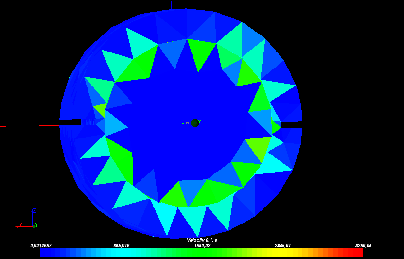

The top picture you post has one cell between the outer wall and the interface. This will not be enough to get anywhere near realistic solutions.
Try refining your mesh, it needn't be too far but your current mesh is not suitable. I'm not familiar with Salome's capabilities but look at putting prism layers at the interface and on the walls which will help.
