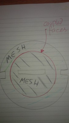

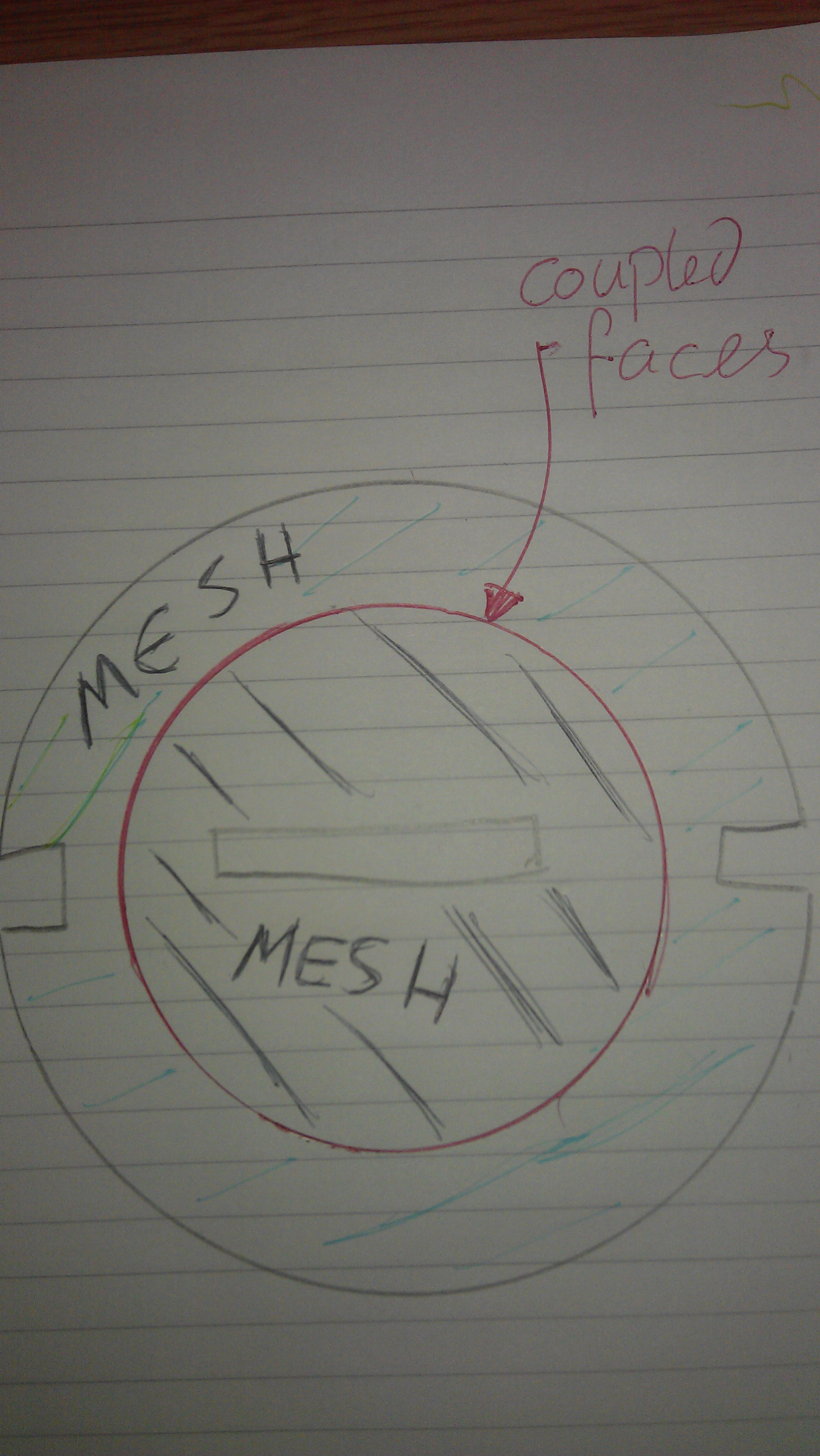

Regarding the meshing you only need to mesh the fluid which I don't think you have. I'll draw a picture it might be easier.,.
JamesMcNaughton
- Posts: 72
- Joined: Mon Mar 19, 2012 1:21 pm
Re: turbine modelling
Hey, so in 2D this is the meshing strategy you should have. You don't need to mesh the solid outer blades just the fluid around them. Likewise for the inner turbine. So two meshes separated by the cylindrical interface (it doesn't need to be cylindrical but if you want to rotate the mesh it will).
Apologies if this is what you have just I cannot see it from your pictures and wanted to be sure you're on the right track..

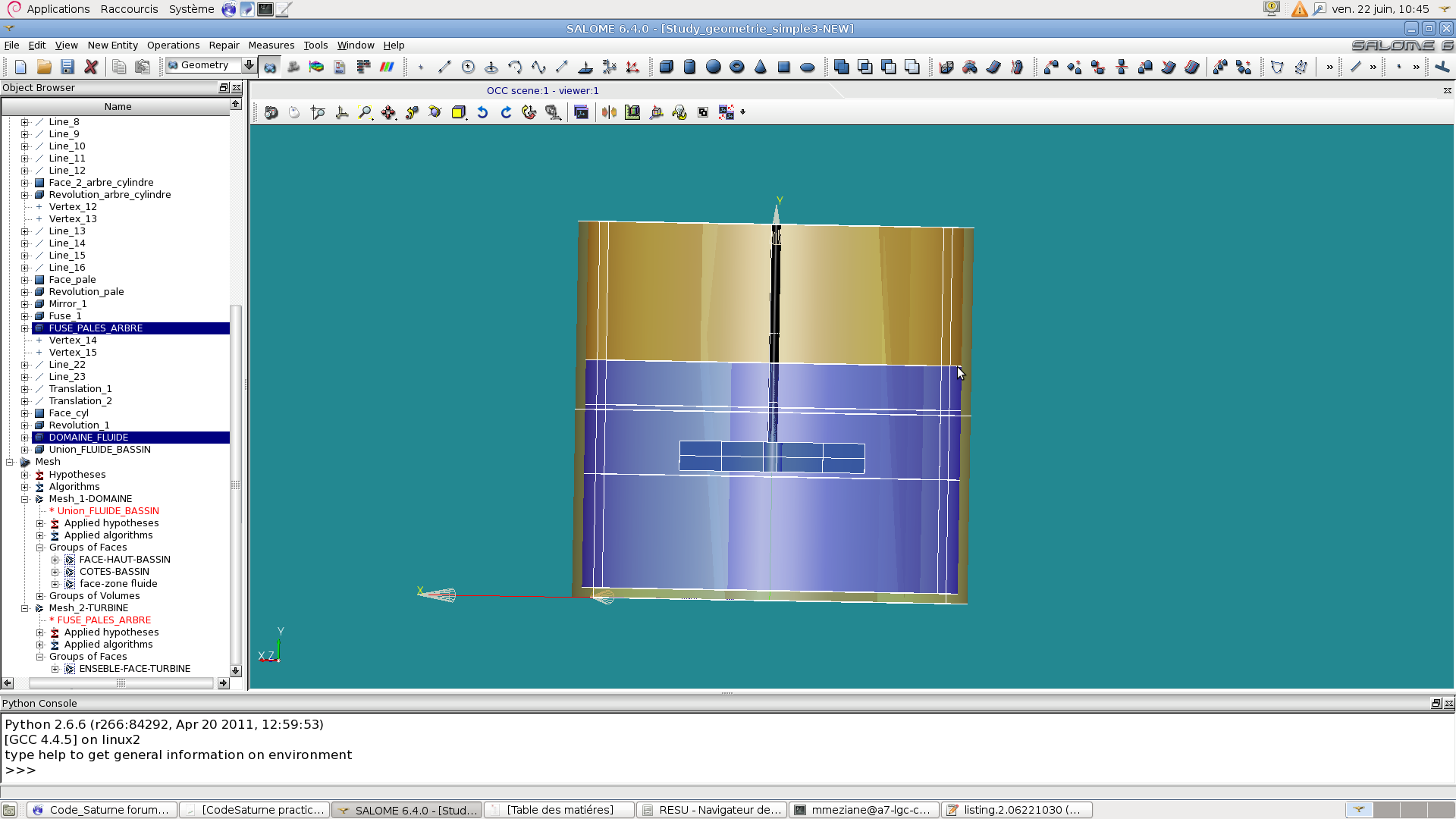

stage75
Hello James,
That's ready what you drew, I attached a picture of my geometry.
But I don't understand how I can declare my turbine as a solid in a coupling SATURNE/SATURNE (saturne that modeling the fluid, no?)

For this type of coupling you should not couple at a boundary face but an an interface in the fluid domain. The interface is not a wall but an imaginary boundary between the rotating and stationary parts.
So in your image (http://code-saturne.org/forum/download/file.php?id=126) you will be meshing only the dark blue fluid region but as two meshes. Split the dark blue region by a cylinder that surrounds the inner blade.
Yes you will mesh the fluid and the boundaries but NOT the solid parts of the turbine.
When you couple the meshes the coupling faces you define in defsat are those of the cylindrical interface you have created. The other boundaries you have are turbine wall etc. These are NOT coupled. This is what I tried to explain with my drawing apologies if it was not clear.
So if you make your meshes as I describe and I think it will all work fine, if you have problems let me know.
