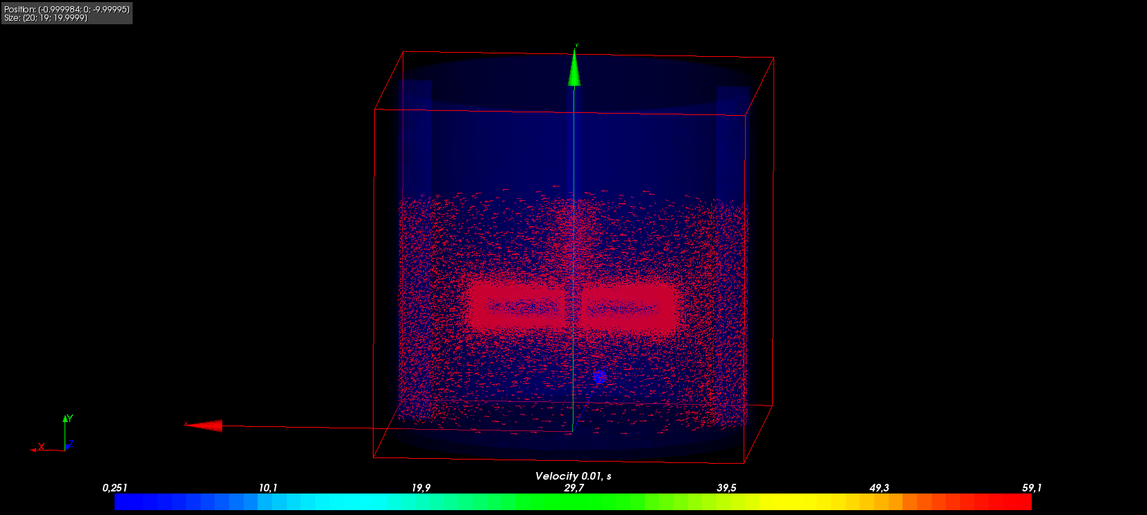

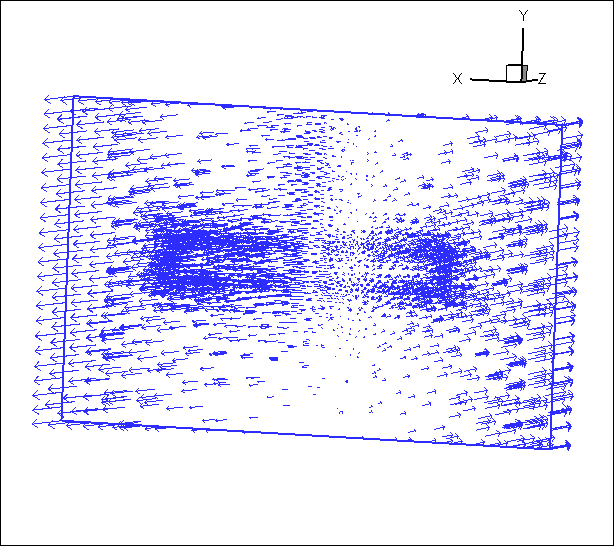

I think the coupling isn't taken into acount because I don't obtiened the recirculation area (vortex). If you look at the velocity vectors, there is no vortex near the blades or baffles (the work flow is like there is no obstacle)!!

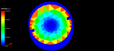

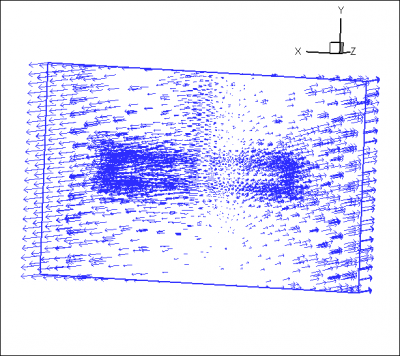

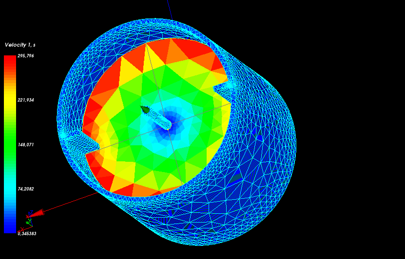

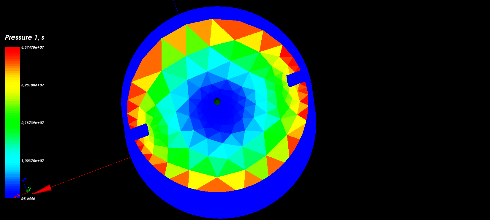

I show here velocity and pressure fields when icorio = 1( if i put icorio =0 i obteined error!)

The mesh is quite coarse. However, there might be an issue with the way you have meshed it (or I have misunderstood the flow).
Is the dark blue region meant to be solid even though it is meshed? Also where is the interface between the two regions?
I expected that the dark blue was just an outer wall and so you would only mesh the region inside this?

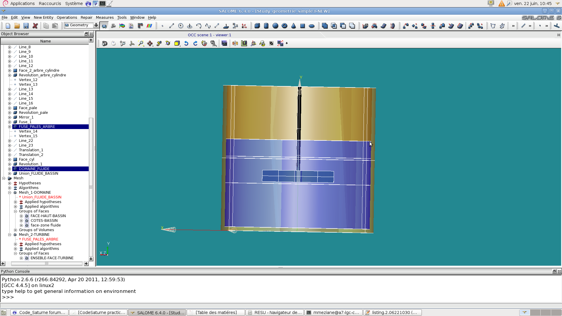

I want to modelling a fluid in a tank and the fluid is rotating around a turbine (the basin is immobile "what I have with a dark blue in the figure above").
This figure show my geometry (in blue couleur is my level of fluid "water" in the tank, in yellow color represente the tank (immobile), and in black its my turbine ).
the whole geometry is meshed! so I have two meshes, the first one represente the fluid (in blue color) and the second mesh represente (turbine and tank the both are immobile but the fluid are in rotation), that's why I did the couplling between two meshes (after the advise of yvan, guillaume, you and others)!

In the simulation result I get good rotation of fluid but there is no effect of the impeller or baffles. So the fluid turns without considering the impeller or baffles (sounds like they do not exist).
