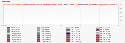

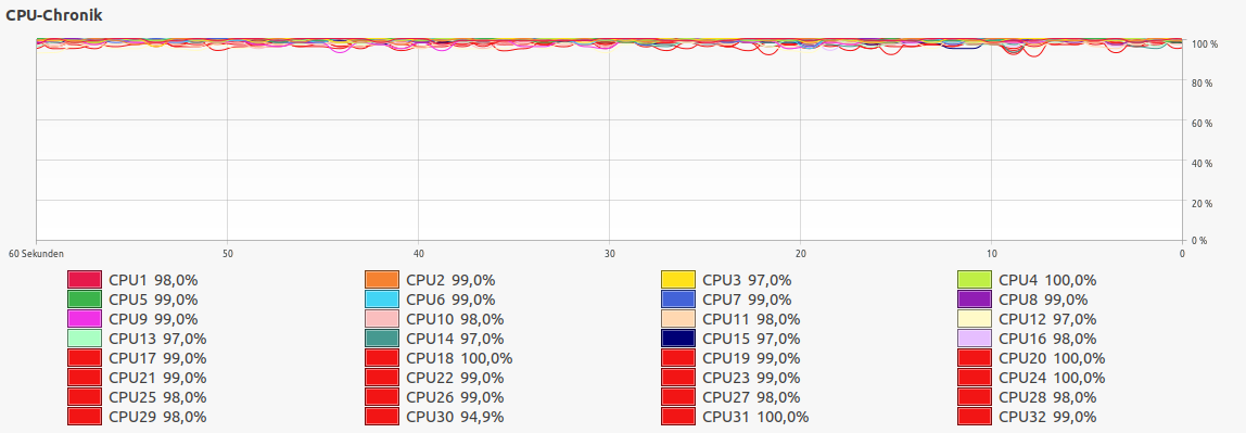

I ran the same calculation for comparison with only one difference. There were only 150.000 time steps. I started yesterday after lunch and expected the calculation to be finished this morning. Somehow strange to me appears the listings file. The time steps listed starts at 1, 2, 3 and so on until 10. Then it jumps to 100! After more than 12 hours running it seems that CS did only 100 steps of 150.000. All CPUs are on 100%. This would be even slower than with my crappy laptop.
Do you have any suggestions? Do I have to edit something in the performance settings? Till now I left everything default.

I have stopped the computation because the calculation stuck at time step 100 and no output under RESU => postprocessing was created. Just the .0001 files.
I wanted the solver to display each 100 steps in the logfiles and create an output each 1000 steps. It seem that there is some kind of dead loop. All CPU's run at 100%, but no output is created. Maybe that's just on my machine. However, no error message is displayed.

In any case, you should only be using 1 thread per MPI rank, not 32.
you have about 5000 cells per MPI rank, which is already pretty low. In some cases, using 2 to 4 threads per MPI rank allow pushing the limits on some large cases an high MPI rank counts, but here, you are probably spending more time syncing threads than computing, and you might have some issue with threading (OpenMP is not as well tested in most parts of code_saturne, and usually on a small number of threads).
Since you have 32 cores, you can use 32 MPI ranks (but the mesh is a bit small for that), or 16 MPI ranks, with 1 to 2 threads per rank, or even 8 MPI ranks (also with 1 to 2 threads per rank) for comparison. Depending on the memory bandwidth and cache, you will get anywhere from about 1x to 2x performance increase between 8 and 16 ranks.
Could you try again with these settings ?
