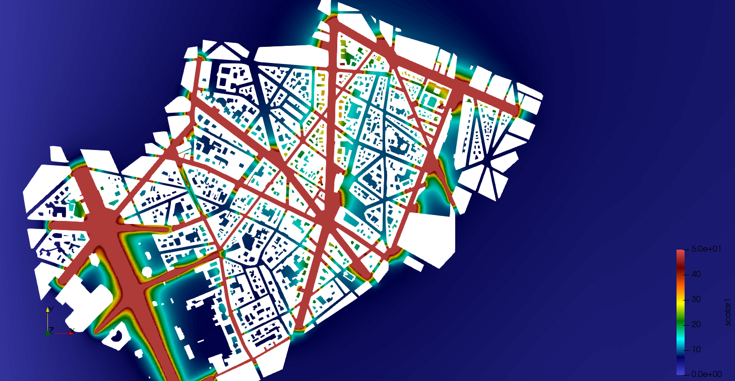

This is a scalar transport which became divergent finally.

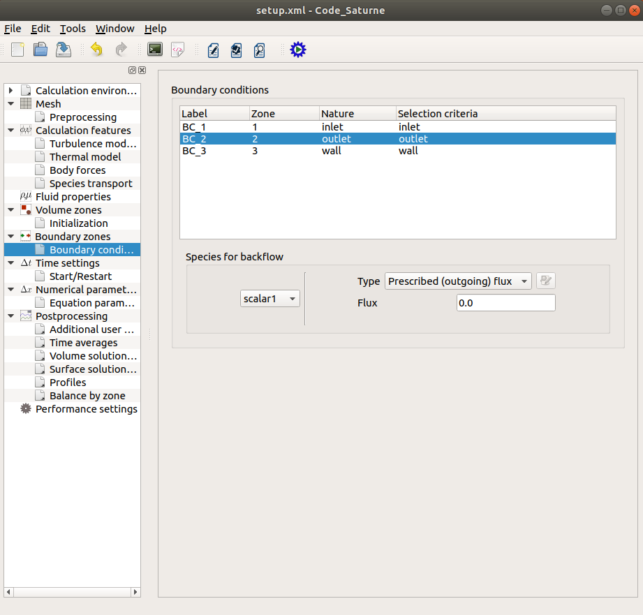

Let me check a thing for scalar transport.
Thanks for you, I suceeded to caculate scalar transport on frozen velocity.
Now, I am littele bit confused about "Prescribed (outgoing) flux" for scalar in GUI.
In here, I want scalar to be flow out naturally, not forcibly.
So I just impose Neumann condition (0 gradient) for outlet boundary. In this case, should I put "0.0" in "flux" in GUI, shouldn't I? or Does "0.0" mean "no flux" (equal to wall condition) for outlet boudanry?

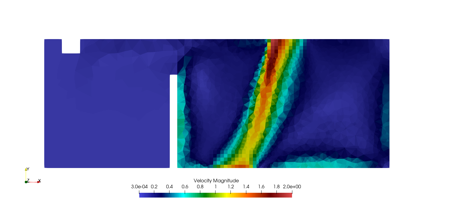

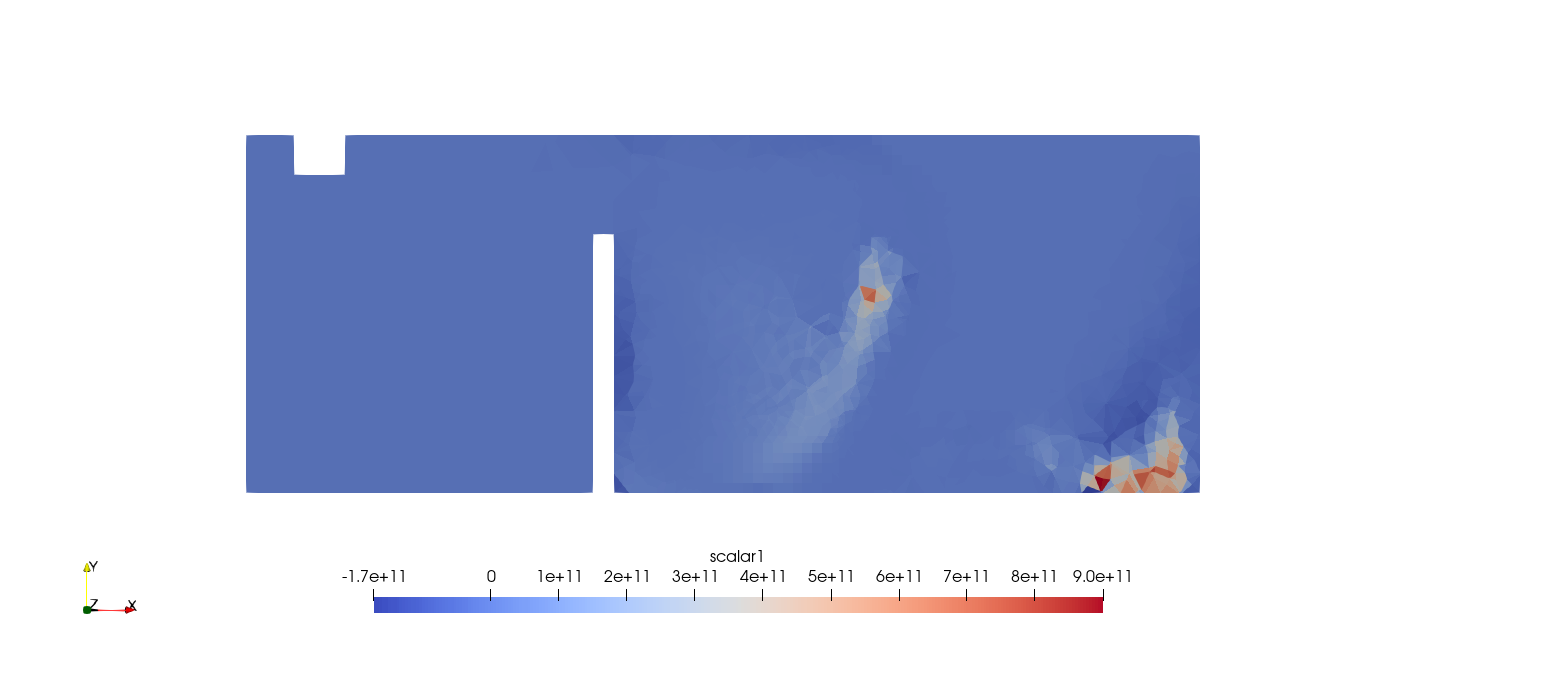

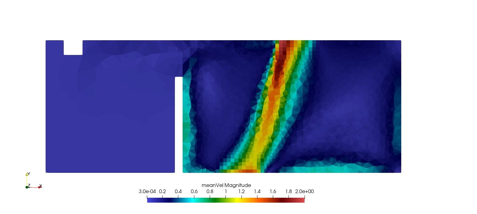

Sorry for restarting from old posts.
These days I had some problems when I overwrite the velocity field with the average velocity field.
Replacing velocity with the average velocity works. No problem happened here.
However, even though it works, scalar transport cannot be solved based on the average velocity field.
Surprisingly, it looks like that scalar transport is solved based on the velocity field which has only 0 velocity magnitude.
Could you check what happened here as soon as possible?
files.zip
(112.43 KiB) Downloaded 1044 times
The first picture is the velocity field, which is frozen and is already replaced with the average velocity.
The second picture is scalar transport. As you can see, the scalar is not transported with the flow.
I think some kind of errors happened when replacing velocity.
Sometimes I succeeded in calculating scalar transport in the same procedure but sometimes this problem happened.
