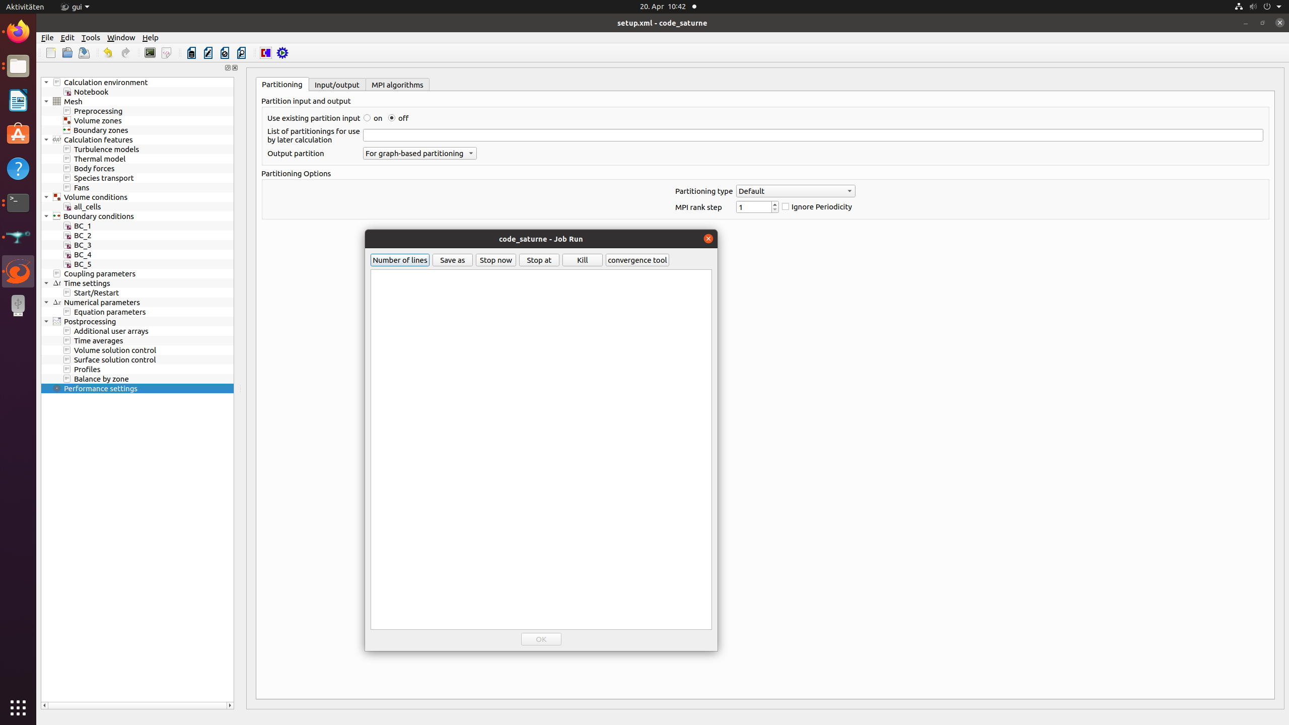

I made it. CS 7.1 is running. However, I didn't see anything in the Job Run window after starting the calculation??? I opened up the old .xml from CS 5.x and tried to run it in CS 7.1. There is no error message. The cursor just shows the little loading circle and the Job Run remains empty.
Have you had a problem like this before?

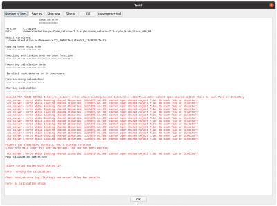

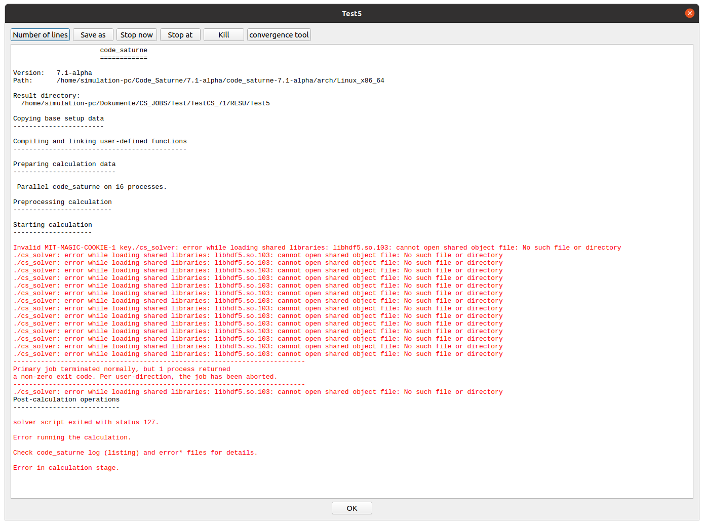

I guess it was because I used some too old files. I created a new case and now it begins to run. Is it correct that I cannot use more than 16 cores for calculation? Or is it possible to increase this number?
If I use 16 cores the calculation stops at the "Starting calculation" stage (see image attached). It seems that some libhdf5 libraries are missing. Do I have to install them separately? When I used the install_saturne.py I switched the add. packages ,including hdf5, to yes.

- Posts: 4272
Re: PROBLEM IN THE BOUNDARY CONDITIONS USING COMPRESSABLE MODEL
There is a huge variability in performance based on processor types, but code_saturne is mostly memory-bound, so data-transfer to and from memory and cache are at least as important as processor speed. On any processors (and I believe this is the case for at least/most some Ryzen models), you can saturate the memory bandwith even without using all the cores. This will also depend on your mesh size (with a smaller mesh you might fit better in cache).
Do you have performance comparisons with other machines for the same case ?
