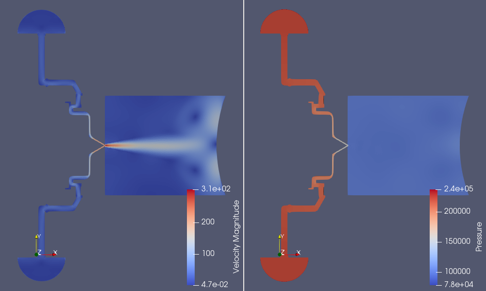

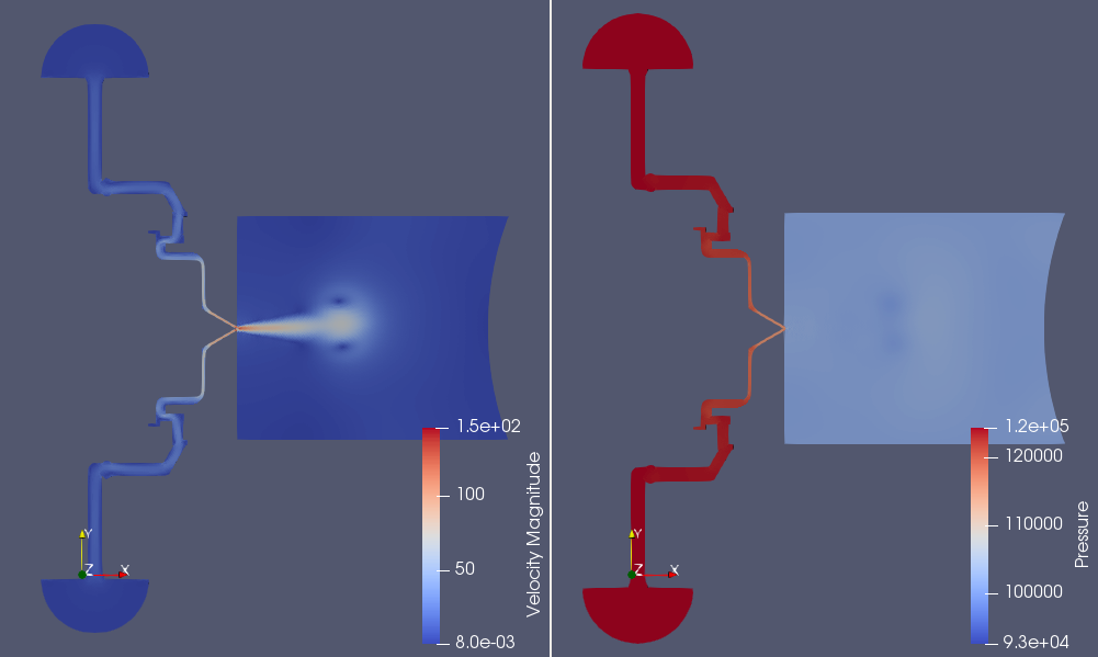

Re: PROBLEM IN THE BOUNDARY CONDITIONS USING COMPRESSABLE MODEL
Hi Yvan
I also see a not very convincing difference in results between versions. A factor 2 on velocity and pressure.
After 3.5ms in v7(from github): After 3.5ms in v5.04: I tried to run a incompressible steady solution to have something to compare with but I the solution is unstable. If you have a standard test case (maybe also a bit smaller) I could try that, if you want.
Edit: I just realized that the "Fluid properties" tab has now disappeared. And stays gone, even if I delete ~/.config/Code_Saturne and creates a new case structure. So my v7 is not functional anymore so I may not be able to assist with testing with the newer versions than v5.
- Posts: 4299
In v7.0, fluid properties can be defined separately by volume zones (mainly to allow for easier setup of fluid/sold internal thermal coupling).
So the fluid properties are now in the "volume zone"s tabs.
As for the difference between v7 and v5.04, as I said in my previous post, v5.0.4 already had a bug, in which the imposed inlet velocity was not taken into account (to verify it in v5.0.4, simply change the input mass flow in the GUI; you will probably have no change in the solution due to that bug). So v7.0 (or v5 from GitHub) should be better.
Regarding the steady state test case, are you trying to run this on the same case ? Given some velocities, the compressible aspects may have some influence, and perturb comparisons.
The ideal solution would be to have experimental results on this test case, or a test cas with experimental results on which we could match this. I am not too sure about the imposed inlet either: whether before of after the patch, the flow rate does not seem to match, so I assume there is an "unsteady" aspect,
Comparing with a subsonic inlet condition would be interesting. A way to turn the problem around may be to use the Laval nozzle test case, currently using a subsonic inlet condition, by using a prescribed inlet (based on postprocessing of the current setup) and check that results remain similar.
There a a few (not many) additional boundary condition options for compressible flows, available in user subroutines but not in the GUI. Maybe post v7.0, we could try to add them to the GUI.
