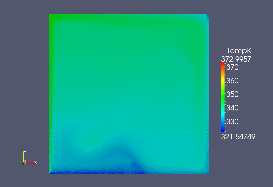

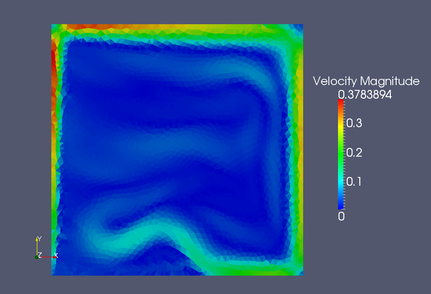

I will recompile it as you suggested. I have another issue. Finally
I am able to run the computation for some times with a single prismmesh in thickness as suggested by
Alexandre on May 27. Now the issue is the computation crashed after
30000 time steps. I could not figure out the reason of this crash. On
the terminal it wrote
"Killed
Error running the calculation.
Check Kernel log (listing) and error* files for details
Error in calculation stage.
But there is no error file and the listing file has been ended abruptly. The listing file is attached below.
Moreover, what ever the simulation results I got up to 30000 time
steps that does not seems to be right. The velocity field and
temperature variations within the domain is attached here. I simulated
the same test case with other CFD software and got different results
which is compared with published results. I am trying to benchmark
Saturne, so we can use for our further studies. I also plotted the
temperature variation at the mid height of the cavity along X axis that
is also does not look correct. In my simulation, I have a 2D square
cavity with two constant temperature vertical walls and two adiabatic
horizontal walls. Natural convection is happening inside the cavity
with radiation effects. It looks like somehow the domain is loosing
temperature. The results are attached here though the simulation did
not reach steady state within this time steps. I am concern about the
velocity and temperature field predictions. There may something wrong
with the simulation. If this is the case, please let me know. The case
file and mesh file are also attached here.
Thanks and Regards
Mita

Mita Sarkar
Re: Convergence Problem to Simulate Natural Convection (Buoyancy Driven Flow) Simulation
In my previous post I could not attach the results plots. So, They are attached here. In my simulation, on left vertical boundary I specified constant temperature as 373 K and on right vertical side wall it is 323 K but the temperature profile at the mid height along X (horizontal) axis does not show that.
