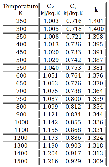

so far I can say that your cs_user_params works. I can't see any negative pressure. The difference between cp and cv is just the isentropic exponent k.
Next I will compare the calculation results with our experimental results. I will make two runs. One with the stiffend gas model and another with a strong mesh refinement at the nozzle outlet. It could be that a millimeter mesh size and a bit below is still too coarse to correctly capture all these physical properties. Therefore, this could be another reason for the underestimation. But for now it is hard to say.
