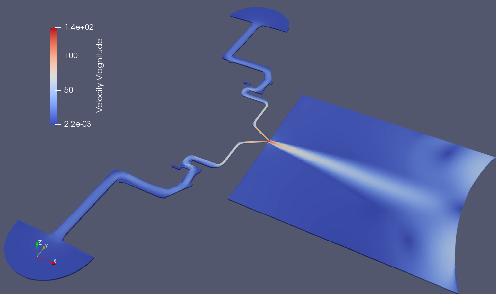

PROBLEM IN THE BOUNDARY CONDITIONS USING COMPRESSABLE MODEL
Re: PROBLEM IN THE BOUNDARY CONDITIONS USING COMPRESSABLE MODEL
Dear Yvan, if you change the time step from 0.001 to 1.0e-6 the simulation will run on v5.0.4 as verified by attached animation video which I made with the latest xml input from Christopher edited ONLY on the time step setting. The video shows the first 50 time steps of 1.e-6 - long enough to show a healthy propagation of the disturbance from the suddenly applied inlet flow.

Dear Christopher and Yvan.
Since this seems the opportunity to promote getting functionality back into the compressible module I have made another run with the case. Based on the most recent xml file provided by Christopher except for the time settings.
Yvan - Regarding negative energy error, It IS related to time stepping. It is clearly stated in the manual that Courant numbers should be limited to 0.4. For a fine mesh this WILL mean small timesteps.
For this run I used constant time stepping of 5e-07 seconds asked for 20000 timesteps (10ms total) and left the computer running overnight. This timestep will just fulfill the recommendation of CFL<0.4 for the full domain over all time steps.
For your consideration I have generated 2 new videos for the case. Exxon_IV shows the development in Mach number and Exxon_V shows the jet formation outside the nozzle. All looks pretty good to me,
You still need an older Code_Saturne - like my v5.0.4 to complete such simulations. I cross my fingers that it will be possible in future releases again.
