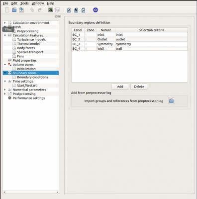

Yes, it is surprising that the pressure is non-monotonic. What type of boundary condition did you use in the GUI ? The user Fortran subroutine only replaces parts you speify, but may leave some other values, so it may be interesting to specify the inlet as being a free inlet/outlet or an outlet. Specifying it as an outlet is not a very good solution because the inlet values for scalars are not defined, but for velocity, this is not an issue, so it may be interesting to try it as an intermediate step.

In GUI, I selected usual boundary conditions as followings; Soryy I am not sure what you mean.
Do you mean it is better to try to specify the inlet as being a free inlet/outlet or an outlet as an intermediate tep?
