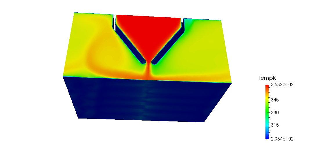

Here are the XML files, most of their settings are the same, only a small part is different. And the setting of the Periodic Boundary of my test model is wrong because it is a test. Another point, the biggest difference is that the mesh of the test model is very rough, and I do not have a boundary layer on the test model, but I have done boundary layers on all boundaries for the formal model.

Re: How to plot residuals in Windows?
There are several differences in your setups, but the one with probably the most impact is the fact that one of the 2 has a sliding wall, while the other does not, so this may affect heat exchange quite a bit.

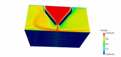

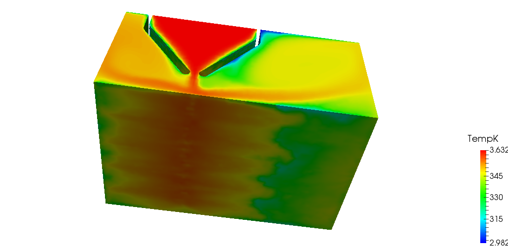

I can confirm that has no effect on heat exchange, I have calculated one with sliding wall, the result is still no heat exchange。
Is it possible to explain this because the mesh is refined and the boundary layer is added? They lead to no heat exchange.
You carefully observe the first picture, the color of the middle of the cardboard changed a little bit, is it because I calculated the time is not enough?
