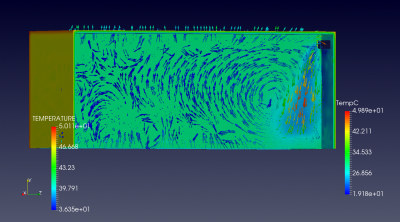

Success!
I build a 3D model (coupling walls of a house to the volume inside) and got it working. See attached picture.
As far as the 2D model.. I did build it from scratch but after opening the Syrthes example (solid-coupling.syd) after you mentioned it I saw what might have been the error. In the tutorial the boundary under conjugate heat transfer only shows a 1 (instead of 1,2, etc.). And on the Saturne side the boundary is actually called 1. So I thought you specify the fluid boundary number in both Syrthes and Saturne. But now I realize that you specify Syrthes coupling boundary in Syrthes and Saturne coupling boundary in Saturne.
