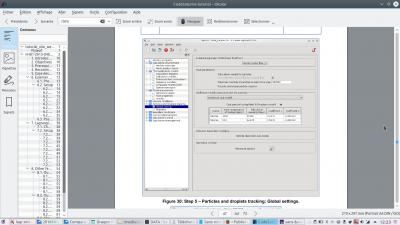

Hello.
I currently using the Windows version of 4.0.5 Code_Saturne and I performed the tutorial "Simulating pulverized coal combustion, coal / biomass co-combustion abd slaggingin a furnace using Lagrangian approch in Code_Saturne". The First stage took place without problems; but from Chapter 7, I encounter difficulties such as the number of particles existing in CS-3.2 and not exixste in CS-4.0.5
But I tried to do and fails to calculate the first iteration. And e do not know how to fix the errors that have me the file "listing.log".
I joinds to all this the following files:
