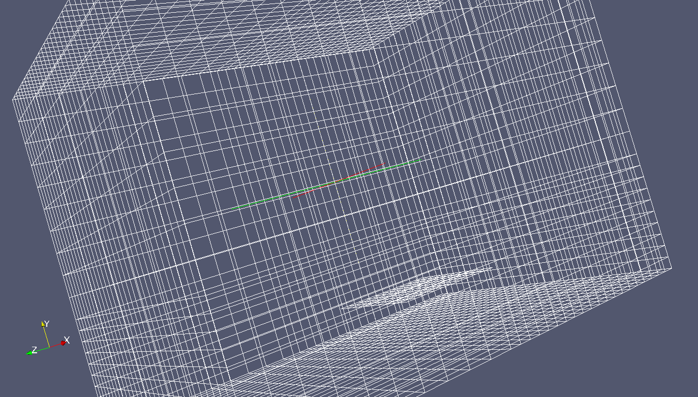

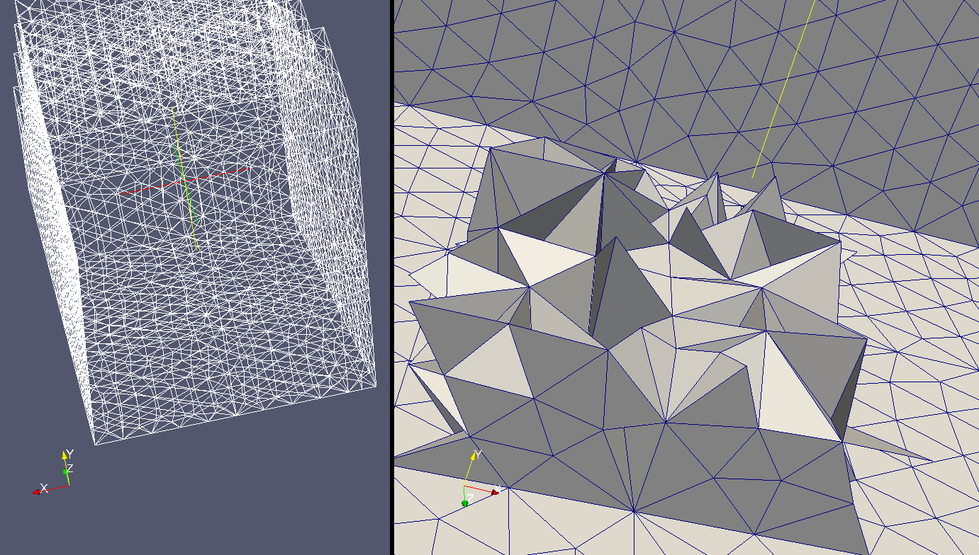

Thinwall is taken into account (see picture attached) but you can't use thinwall in your mesh. The thinwall function transforms interior faces into boundary faces so you have to select a 'plane of interior face' to create a wall. In your mesh you haven't any plane formed with the internal faces so you can only create strange geometries.
JF
I suppose test16.med is your mesh.

Thank you for the picture, I understand very well what is happening! What software and file did you use to make it?

I opened the RESULT.case with ParaView (open source).
I don't understand: you tried to make a plane (thin wall) in Salome ? If the thin wall doesn't appear then it is not existing... Postprocess your RESULT.case with Paraview or Ensight and you should show the walls (or/and thin walls).
