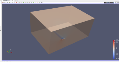

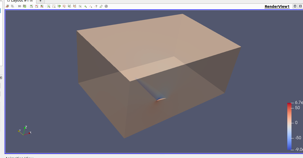

Setup and run solver log. The mesh is too large to attach, but it's simply a fluid domain with a wing subtracted from it, there's an inlet an outlet, symmetry conditions and a wall for the wing surface. The faces are labelled with names that are these. All I would like to do is for those to be preserved in the output so that I can query them, for example to read the lift, drag and moment of the wing.

The selection criteria for the postprocessing mesh is incorrect. You must either:
- Use "wing.Wing_surf".
or
- Switch the mesh type from "boundary faces" to "boundary zone," and keep the "wing" selection.

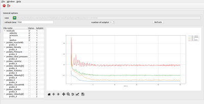

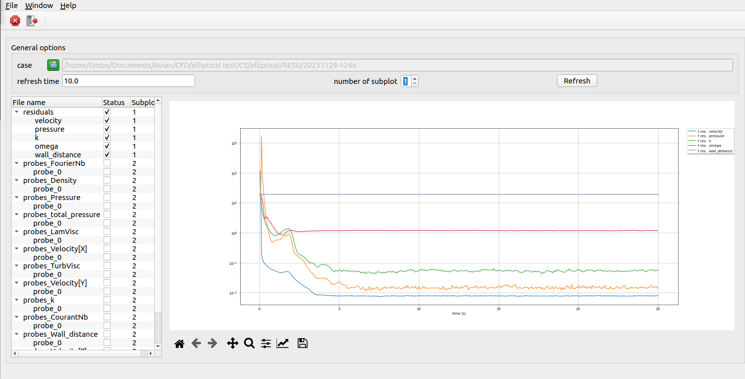

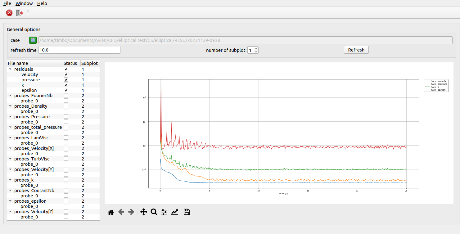

Hi there, I've tried it with kε, kωSST and with rough (height 0.0001m) and smooth walls. All do seem to converge for me within the 500 steps of 0.05s. Here's the plot of kε with a smooth wall:
kωSST does seem to converge quicker for the smooth wall case:

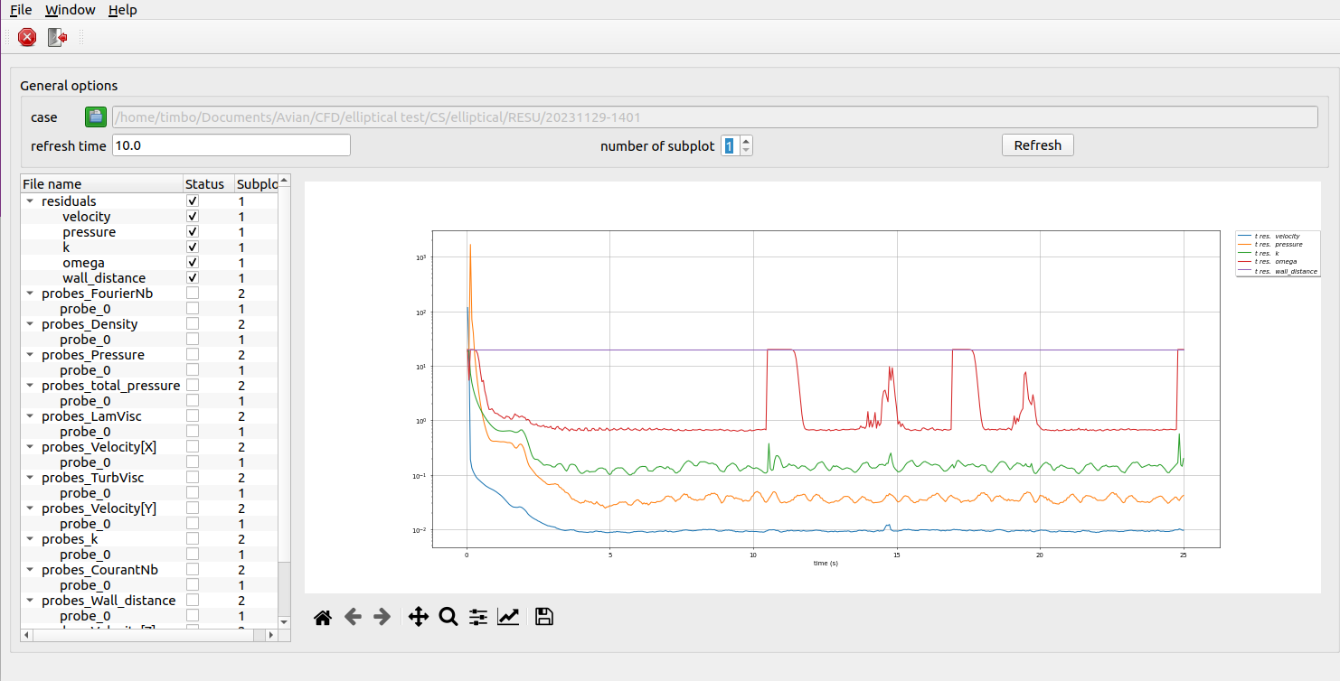

However for the rough wall then there are some odd jumps:
However, none of these give numbers that are anywhere close to the results from my other sofware (although they are all quite consistent with each other). I would assume this is my fault with setting up the model rather than a bug, but it seems very odd.

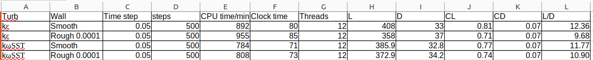

Turb Wall L D CL CD L/D
kε Smooth 408 33 0.81 0.07 12.4
kε Rough 358 37 0.71 0.07 9.7
kωSST Smooth 386 33 0.77 0.07 11.8
kωSST Rough 373 34 0.74 0.07 10.9
The correct CL should be 0.97, CD 0.05 and L/D = 20

Sorry, can't work out how to format a table to post here. Here are the results in a bit more readable way:
